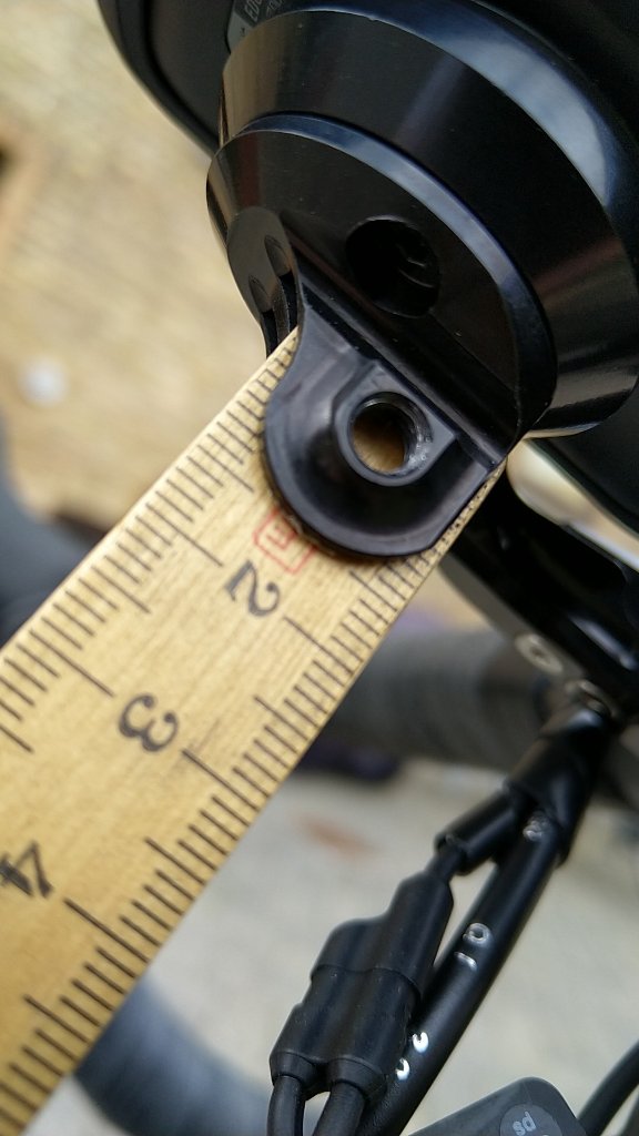

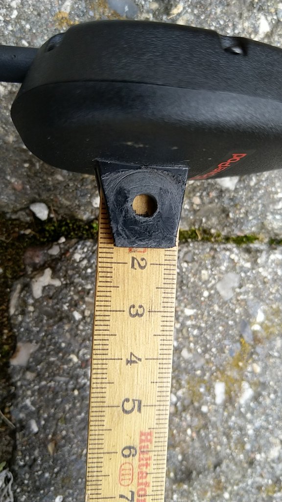

Velocomp wrote: Fri Sep 11, 2020 6:03 pm Post some photos...
Here they are. As can be seen the mount is ap 2mm shorter than the longest leg on PP. I was able, using force, to attach it but the missing 2mm means that the pitu tube points up and cannot be put in a down wards direction.

Re: k-edge combo mount
We've had the same GoPro mount design for 5 years now. We have had zero problems with any mounts...ours or others.
We used to buy mounts from K-Edge, and their GoPro attachment was from machined aluminum. Their original mounts worked just fine.
On the link you provide the K-Edge mount is said to be "new". On this new mount it looks to me like they changed the design of their "head" from machined aluminum to a plastic part (which in itself is OK) but apparently they changed its dimensions. Changing internal dimensions is not OK.
We have put notices up on our webstore about this particular combo mount.
