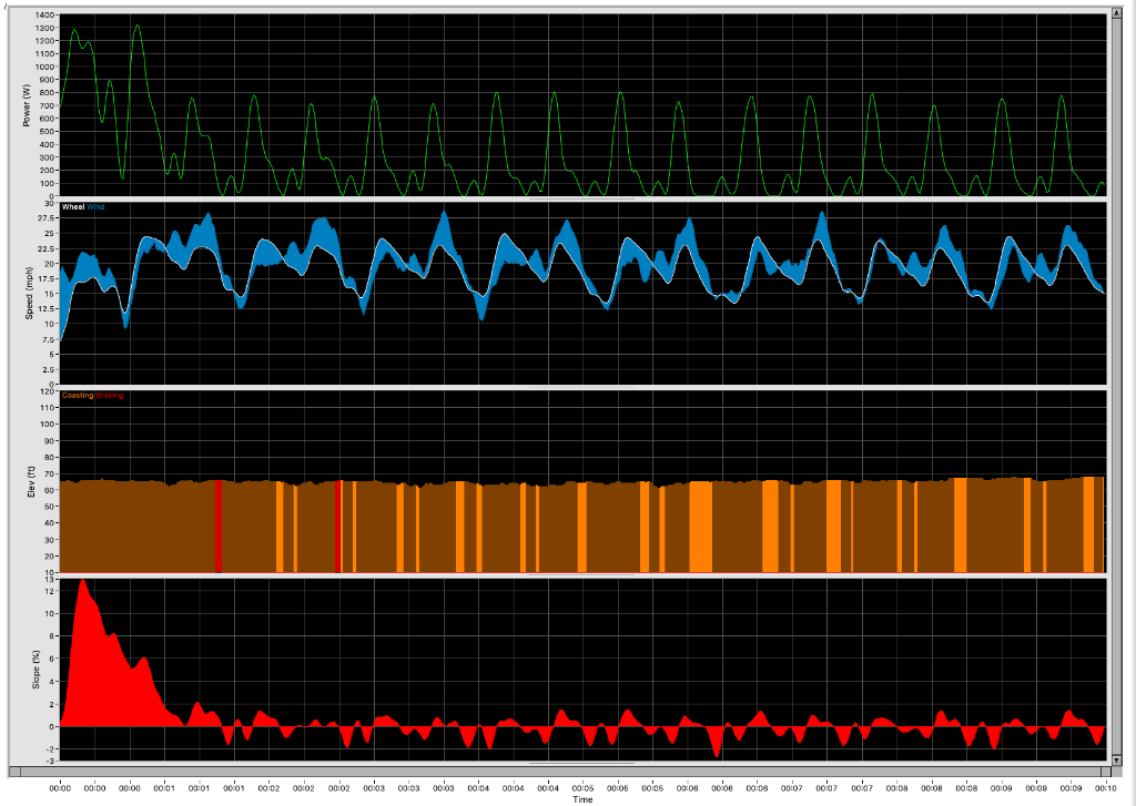

I did a training ride today, short bursts, and once finished PP gave me for the first 2 go's a far to high power value,
over 1300 Watts.
now i checked using 'Analyze - Check calibration' and it showed me that a correction would change the values significantly:

The problem is the first 90 seconds of your ride. PP was in a very different rotational position compared to its original cal ride. You can see this from the very high slope at the beginning of the ride.
Screen Shot 2020-08-17 at 1.22.26 PM.png (147.11 KiB) Viewed 8048 times
I edited out the first 90 seconds of the ride, then applied the Check calibration feature for the remainder. This worked. Your PP was pretty close to being correctly calibrated, so the correction doesn't make much of a difference.

thank you, but where does he take these wrong rotation positions from?
Re: low Fric unable to update profile
If you remove PP from the mount between rides, or you bump it during or between rides, or you walk with the bike with PP on, any of these things can cause the tilt calibration to change. During the first 90 seconds of each ride, if there is an issue PP will automatically correct itself.
