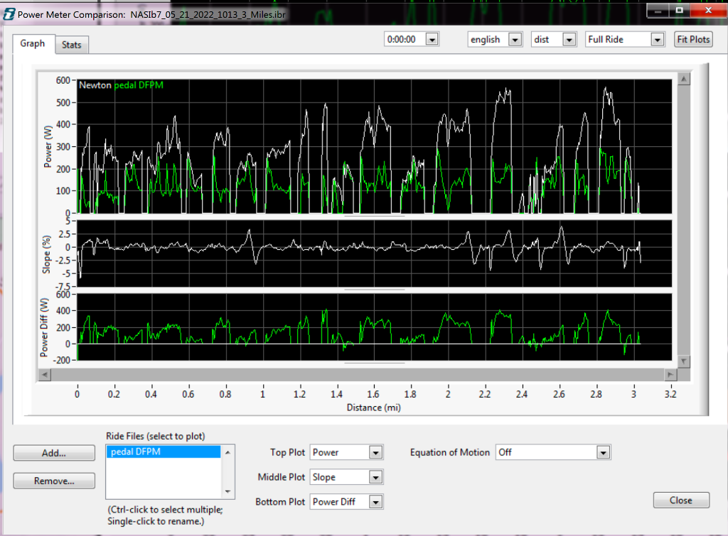

Here is a ride I did just this morning. I'm using a PowerPod (Newton) that records the total power produced by the cyclist and motor, and the power applied to the pedals (Assioma).
VTorque is controlling the motor, and in this test the idea is to keep the cyclist pedaling at roughly a constant 100W, independent of bike speed, wind conditions, or hills. VTorque tells the motor how hard it must work to maintain the 100W set point goal.
In the graph, the total power (white, TOP GRAPH) produced by the cyclist and motor is as much as 500W+. Highest power happens on a hill (slope goes + and -).
The green line in the top-most graph shows the amount of power I'm applying to the pedals; it hovers around the 100W mark. "pedal DFPM"
The bottom graph shows the difference between total power (cyclist + motor), and cyclist power; this difference is the motor power. As you can see, the motor power varies all over the place, as it should, in order to keep the cyclist pedaling with roughly 100W of effort, irrespective of changing wind, slope, and speed conditions.
So, with VTorque, riding an eBike is like riding a normal bike, but just a lot easier!!
