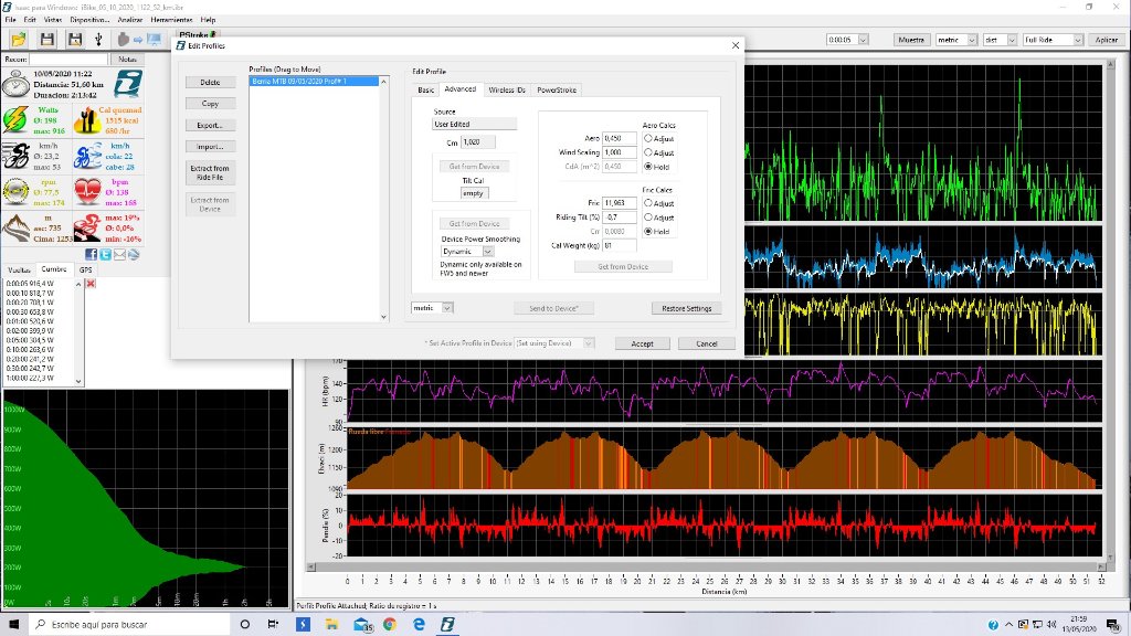

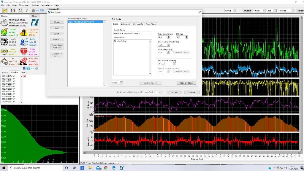

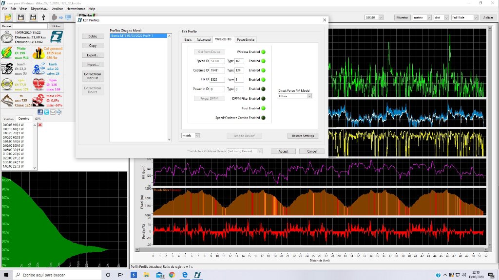

Hello:
I am attaching screenshots of my perfir for the mtb bike to check if everything is correct. I have the doubt if DPS has to be in dynamic or in zero seconds, the power in the Garmin took it to 3 seconds.
Greetings and thank you
