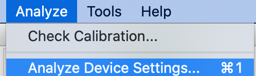

1) Elevation readings are based on baro sensor readings. Baro readings vary with weather.
You can adjust your absolute elevation, after each ride, with this command:
Screen Shot 2020-04-19 at 3.20.06 PM.png (106.32 KiB) Viewed 3862 times

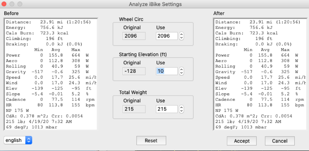

In this ride file I changed starting elevation from -128 feet to +10 feet
Screen Shot 2020-04-19 at 3.20.34 PM.png (142.35 KiB) Viewed 3862 times
Note that changing the absolute elevation won't affect power readings
