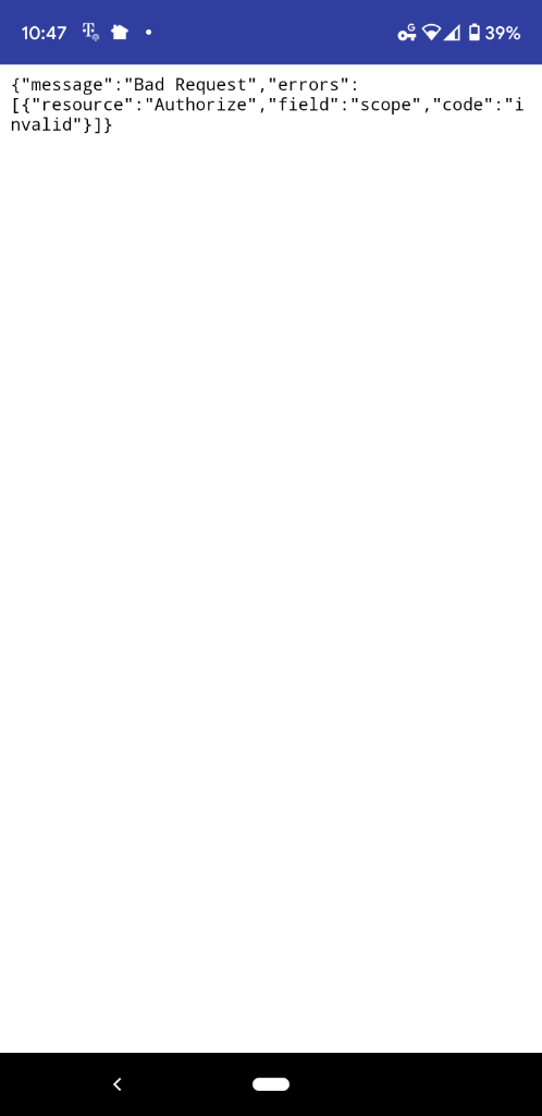

The app works. I connected to the PP BLE and went through the setup. Some observations:
- Scan sensors: I tried pressing the PP start button after waking the speed sensor but the PP would not connect according to an error message. When I pressed the PP start button and held it until the LED went solid it then connected.
- I get an error message when I try connect to Strava. See the screenshot attached.
- How do I know what Profile #1 contains? I have 3 profiles in the PP.
PowerHouse Strava Error.png (30.73 KiB) Viewed 19733 times
texbiker
Posts: 62
Joined: Wed Mar 29, 2017 1:04 pm
Re: Introducing PowerPod Lite V3
Post by texbiker »
Today I went for my first ride since using the PowerHouse app to connect to the PP BLE. As I got ready to leave to start the ride I opened the app and tried to connect to the PP but got an error message that the PP could not be found even though it showed powered up on my Wahoo Elemnt. Afte turning the PP off and back on several times and changing to a different profile (#2) it finally connected. I thought this meant smooth sailing for the ride. NO!
When I rolled out the driveway and pressed start ride on my Elemnt no power readings. I looked at the PP LED and it was flashing red/yellow and starting to count up to 100. I wasn't prepared or expecting a calibration ride. So I rode to 50, stopped and waited then continued the ride. When the count got to 100 I thought it was finished but no watts showed on the Elemnt. I stopped and again the LED was red/yellow and waiting to count up to 100. Resumed riding and the count went to 100. Still no power reading and the LED flashing red. I pressed the PP button 5 times, the LED went out, pressed the button again, red LED. I figured the ride was going to be without power readings and turned the PP off again. Riding a short distance I pressed the PP start button again just for laughs and got a green LED and power appeared on the Elemnt screen.
The Powerhouse app and my use of it must be in conflict. When I select a profile # in the PH app does this create a new profile in the PP and erase the existing profile # in the PP? Does it check the existing profiles in the PP and do anything to them? I am still confused and frustrated using the PP with a new bike with new sensors. This is too hard. Why can I not make a new profile in Issac adding the wireless ID's I can get from my Elemnt app and then go for a ride and the PP make adjustments based on the information I put in the profile in Isaac? If I knew what to expect at the beginning of a ride I could plan on what to do but so far each ride presents an unexpected situation and I must make choices on the fly if I want power readings. Sometimes I may remember what steps to take and other times I have no idea. Too much frustration. I don't have to go through all of this to use my Wahoo Elemnt computer when I add a new bike and sensors. I guess the PP is too sophisticated for me. I bought a pair of Favero Assiomo pedals that look to be much easier to set up and use. Moving them between bikes is easier than the frustration I get with the PP.
iBike_02_20_2020_0019_24_Miles.ibr
(308.93 KiB) Downloaded 636 times
Welcome to the wacky world of BLE.
A BLE device can be paired to only one other BLE device at a time. If your Wahoo is on and your PP is paired to it, then PP cannot be paired to the PowerHouse app.
This particular problem is completely out of our control; it is not a fault of PowerPod.
Note that this problem does not exist with ANT+ devices; you can pair simultaneously to as many as you wish.
I'm not sure what you are trying to accomplish with the PowerHouse app. You can use it (with the Wahoo off) to set up your profile. Then after you pair PP to your sensors and do a cal ride, PP will automatically pair to the correct profile.
Your questions are very fair and I will make a separate posting so that you can understand exactly what is going on.

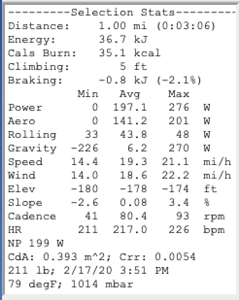

Are you looking in the advanced stats window? It looks like the shot below.
If you see icons instead of numbers in the stats window, place your mouse over the stats window, right click, and select Advanced Stats
Screen Shot 2020-02-17 at 4.31.45 PM.png (56.28 KiB) Viewed 19567 times
