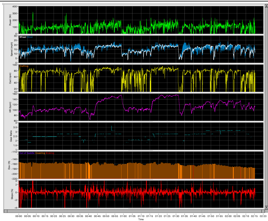

As the title says, now, trying with my carbon mtb.
MTB
Blocked suspension
PPV3
Height 175cm
Weight 69k
Bike weight 12k
Wheels 26x2,20 40psi
Cal ride and 55k ride attached.
i can see in the wind annalisys that i had tailwinds aprox at km49-52 and i can remember that i felt the HEADwind instead.
Thank you very much

I think you are OK.
There are strong headwinds between minutes 30 to 35 and 1:35 to 1:40. There are cross winds for much of the ride headed out, and tailwinds from 1:40 to 2:05
Having done this for 15 years now, my experience is that it is difficult to judge winds while riding. I look at the ride file to see if wind speeds look reasonable; in your ride file, most certainly they are.
