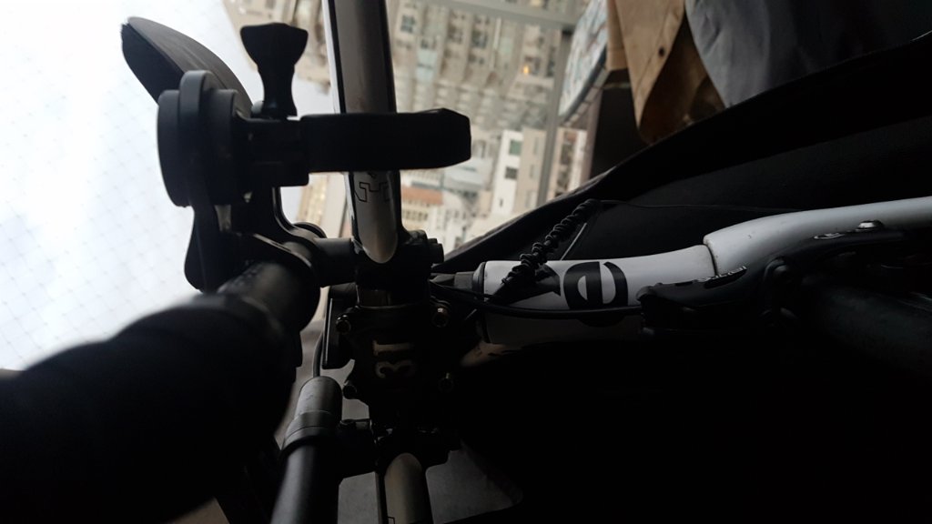

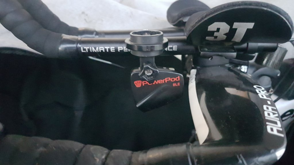

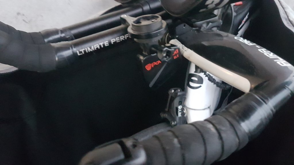

Looks like your wind calibration is low...I used the "Analyze/check calibration" feature to correct it.
Your watts increase to about 158 average, and there are places where watts exceed 200W.
Your wind scaling number is quite high; please post images showing your your PP is mounted.

3 . attach some images... i think is in the correct way,... always was in that place and i think has no problems.

Do a new calibration ride, then post a ride file afterwards.
