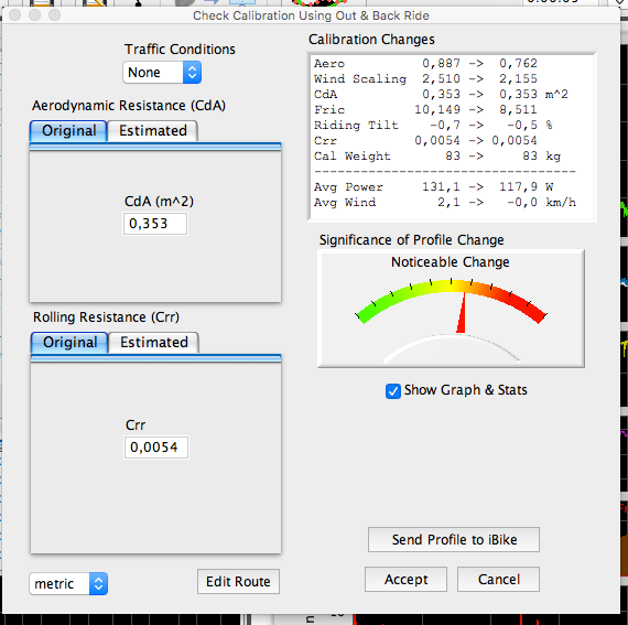

Trying "control calibration" for this ride Isaac still tells me that there is "noticeable change" (gauge indicator is in orange area, here below the screenshot)

Less spikes, but still some sudden "climbs" of power towards 500W and more.
May be the mounting? Or CdA should be lowered, for instance?
iBike_06_25_2019_0633_40_km.ibr
(518.96 KiB) Downloaded 258 times
Re: New PP user - first questions
This looks much better for wind.
Are you using a mountain bike? The spikes are happening at places where you are accelerating.

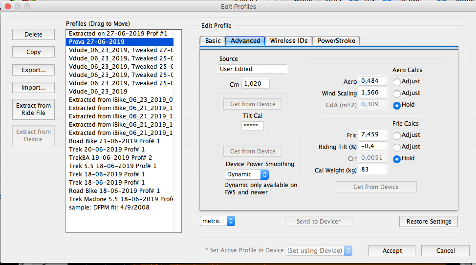

Before your last reply, on Sunday I had decided to change Aero and Windscaling by reducing them after reading here in the forums that some users got better results in downhills by lowering those figures
Sunday's ride was almost entirely uphill, no out&back, but in the few downhill parts of it the Watts I had on display were more coherent with being on a downhill and pedalling with ease.
Here are the settings I tried
Schermata 2019-07-02 alle 15.06.54.png (173.93 KiB) Viewed 6468 times
I will try them again in an Out&back ride tomorrow
Here is Sunday's ride
iBike_06_30_2019_0714_53_km.ibr
(787.29 KiB) Downloaded 210 times
Any opinion is welcome!
Re: New PP user - first questions (updated)
Looks good to me.
