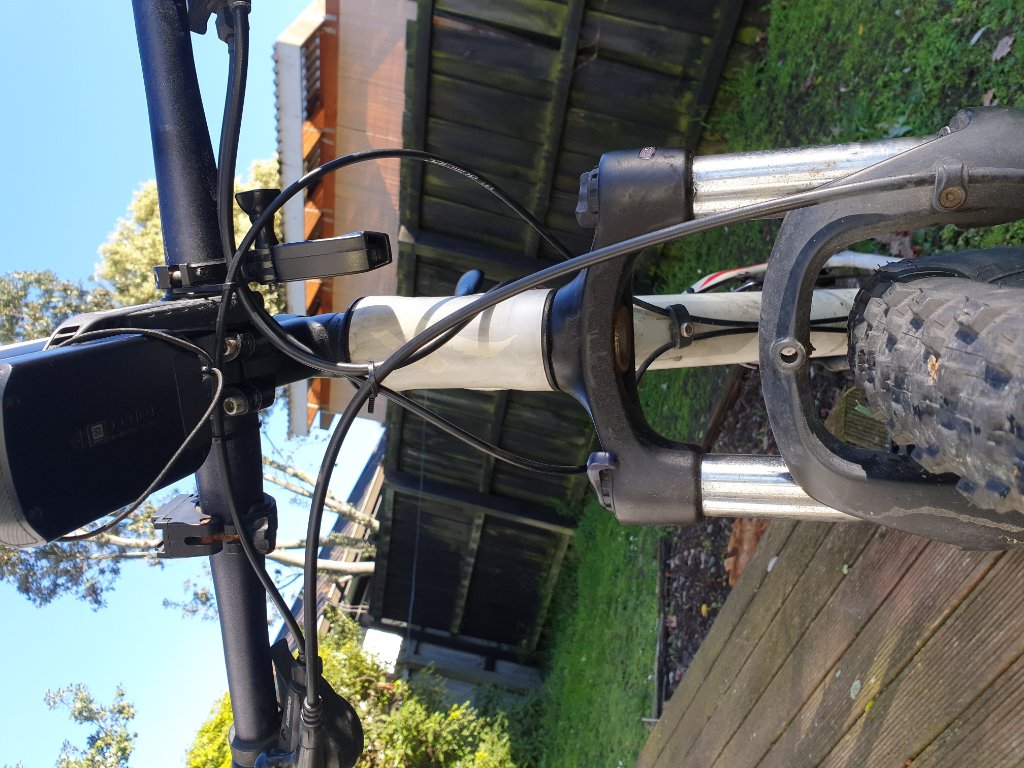

Velocomp wrote: Sun Jun 16, 2019 7:03 pm
Your wind sensor appears to be obstructed. This would cause low power.
Calories are linked to power output. Calories are power added up over time.
Your weight was too high in your original profile. It is not surprising that your power/calories dropped, but please check your wind sensor for blockage.

I have the cables well away from the wind sensor. Seems strange as I had tied my cables back.
Thought I did put my proper weight in profile. 63.5kg? As for cables, have them away from powerpod air duct
Re: Can you check my calibration?
Looks OK. Do another ride and post it.

Here is another ride. I did tie another cable just in case, so hope this is better?
iBike_06_17_2019_1136_3_km.ibr
(31.08 KiB) Downloaded 338 times
This looks better

I have ordered a front mount so I can move it out the front of the handle bars away from cables.
