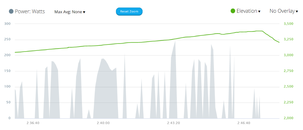

Symptoms: Turn on PowerPod, spin up the speed and cadence sensors, Edge 520 detects all three (plus ANT+ HRM and phone's Bluetooth). Start riding, everything looks good. Next time I check the Edge 520 display, power is reading 0W (despite non-zero cadence, and about 100W effort). For the remainder of the ride, reading on the Garmin will randomly alternate between a valid power reading, 0W, and __W. The valid readings usually don't persist for more than a few seconds. At no point does the Garmin ever report that it's lost connection, or reconnected the PowerPod. Here's a snapshot from the Garmin data:
This is about the fourth time this has happened in the six months or so that I've had the PowerPod. The vast majority of the time it works fine, but just when I think I'm out of the woods, the problem pops back up. The data in the PowerPod is fine and doesn't show any dropouts. I can merge the Garmin data with the iBike file post-ride, but that doesn't help me much during the ride.

Your ride file data is 100% intact. Speed and cadence sensor data are normal, too, so there is no problem with your ANT sensors.
I have used a 520 for the past 3 years and have had zero issues. We have many other customers who also use the 520; again, without complaint.
I am assuming your 520 is mounted very close to your PP--within a few inches. If so, there is no problem with weak signals between the two devices.
