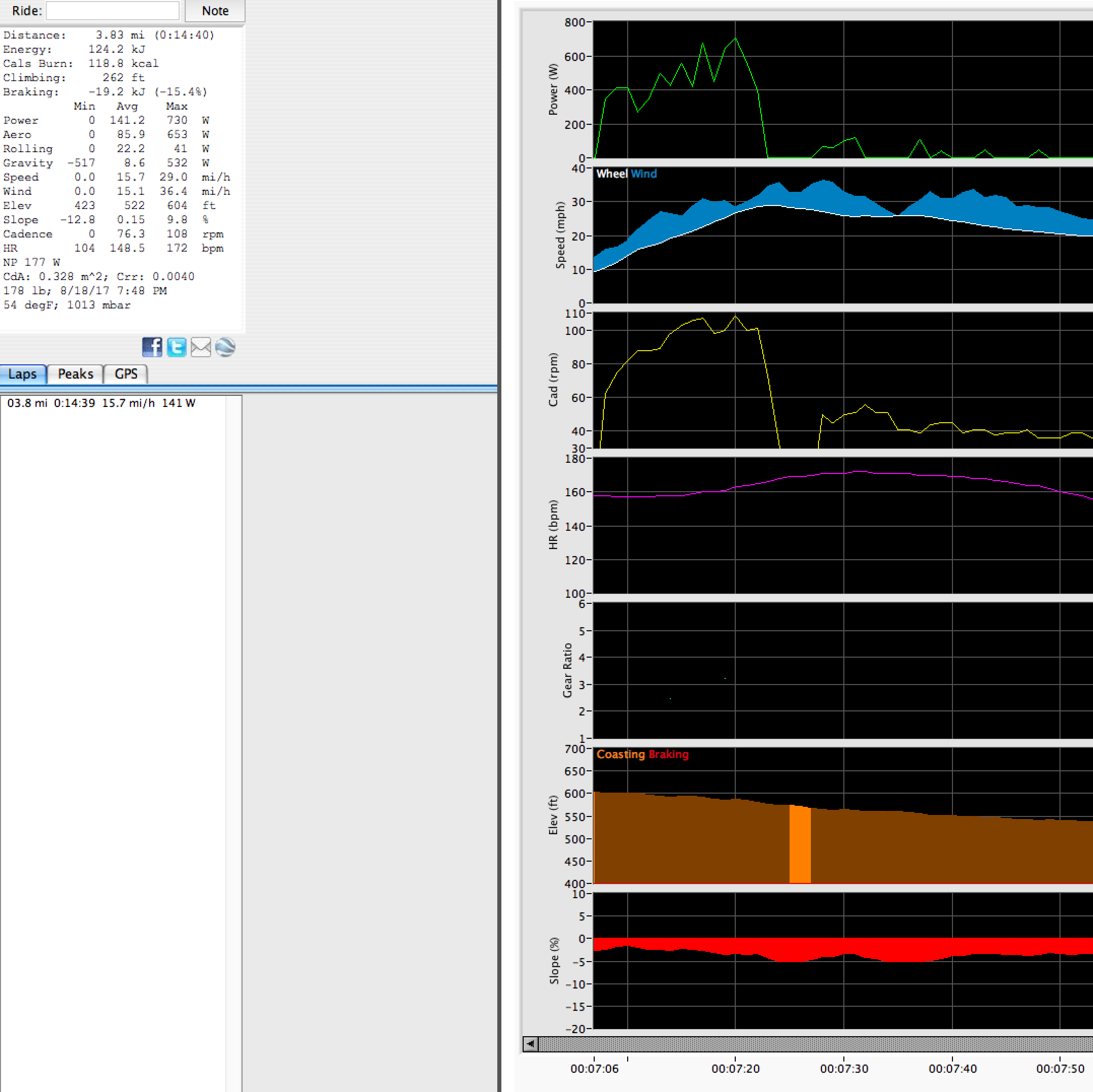

It looks like your coast down starting at minute 7:27 meets these criteria, so here's how to use the data:
1) Set filtering to zero, so you can see the power detail
2) In your file, you can see where you stopped pedaling, then started soft pedaling at 7:27
3) When you first started pedaling at 7:27, there is a brief power "blip" where your cadence was around 50. I'm not sure if this means you accidentally applied a bit of power, so I started the measurements where cadence was steady, at around 40, at 7:35
4) There are 4 small power spikes after cadence stabilizes at 7:35. This means your default value (from PP setup) of 0.328 is already very close: note also that from 7:50 to 8:20 power is zero
Screen Shot 2017-08-20 at 8.01.00 AM.png (294.48 KiB) Viewed 8186 times

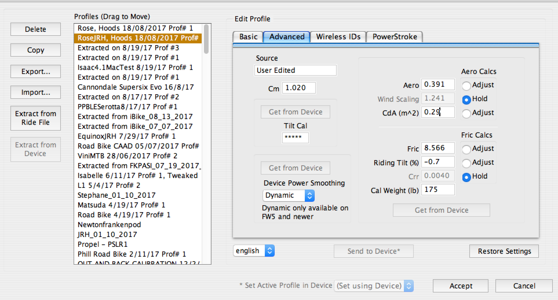

5) I then played with the profile, lowering CdA a bit, and watching the power spikes from 7:36 to 7:49. You're correct that the effect of CdA is more pronounced at higher speeds, so I tried to remove the 4 power spikes from 7:36 and beyond.
6) In the Edit Profiles menu I manually adjusted CdA (in this example, to 0.29), then clicked Accept. IMPORTANT: WHEN CHANGING CDA IN THE EDIT PROFILES WINDOW, MAKE SURE THE RADIO BUTTON IS SELECTED THAT HOLDS WIND SCALING CONSTANT.

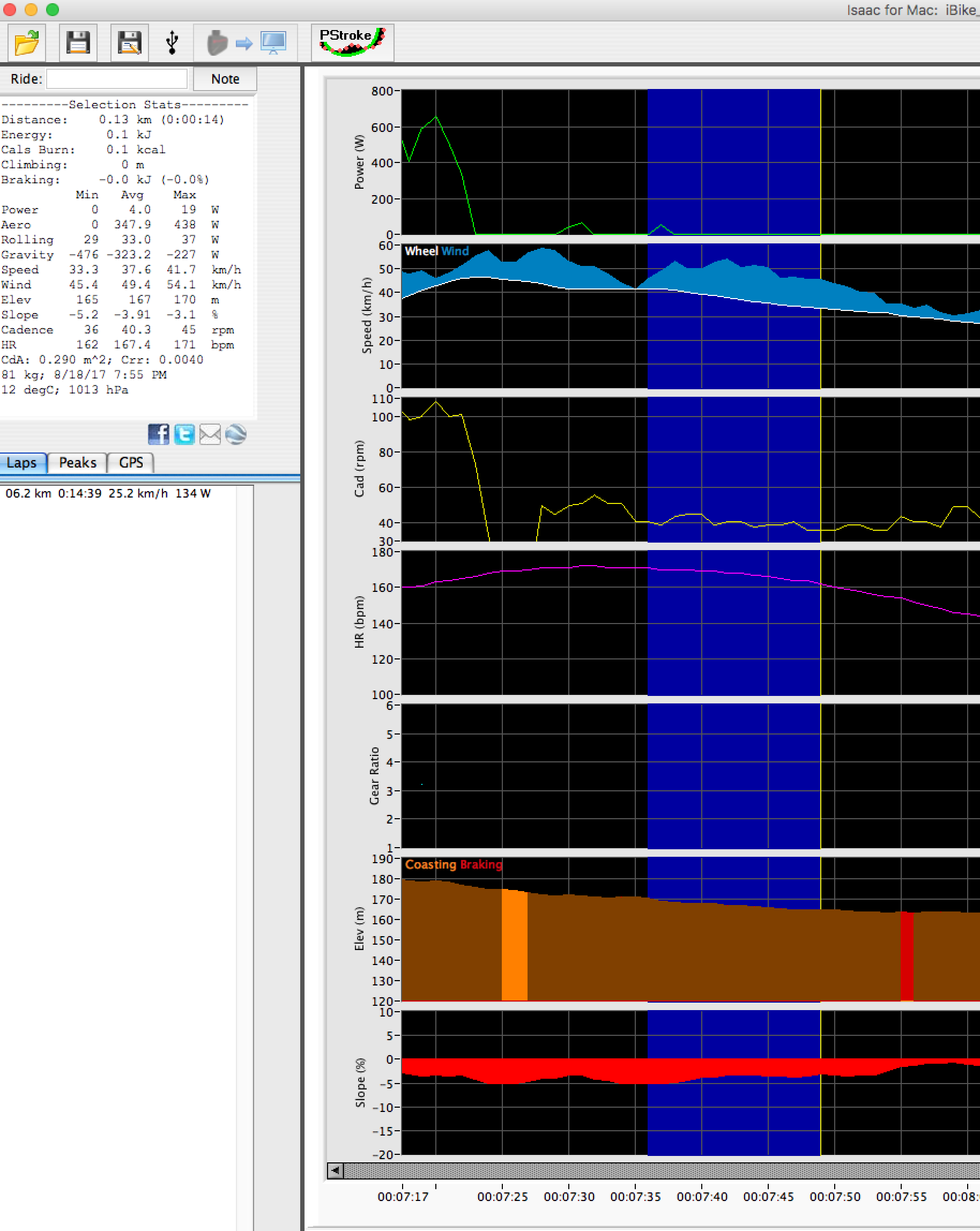

8) Here is the power curve with the 0.29 CdA
Screen Shot 2017-08-20 at 8.36.18 AM.png (320.87 KiB) Viewed 8182 times
9) So, the 0.29 CdA "killed" 3 of the 4 the power spikes that start at 7:36 and beyond. The only question is, is 0.29 too low? Here, you simply have to do some playing around. You want the CdA to be as high as possible, such that it forces downhill watts close to zero. REMEMBER: you won't get it to be exactly zero.

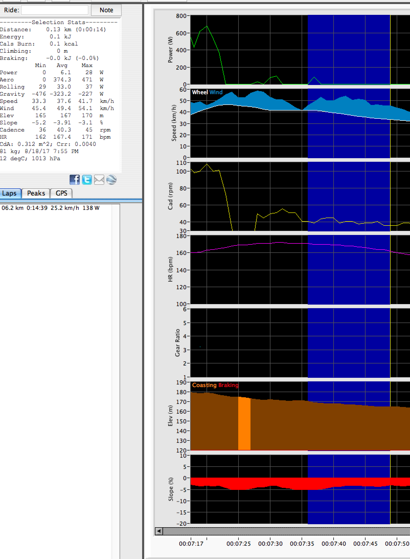

10) After trying this with several values of CdA, I settled on 0.312. This CdA crushed three of the 4 peaks. Average watts from the three peaks in this region is 6W

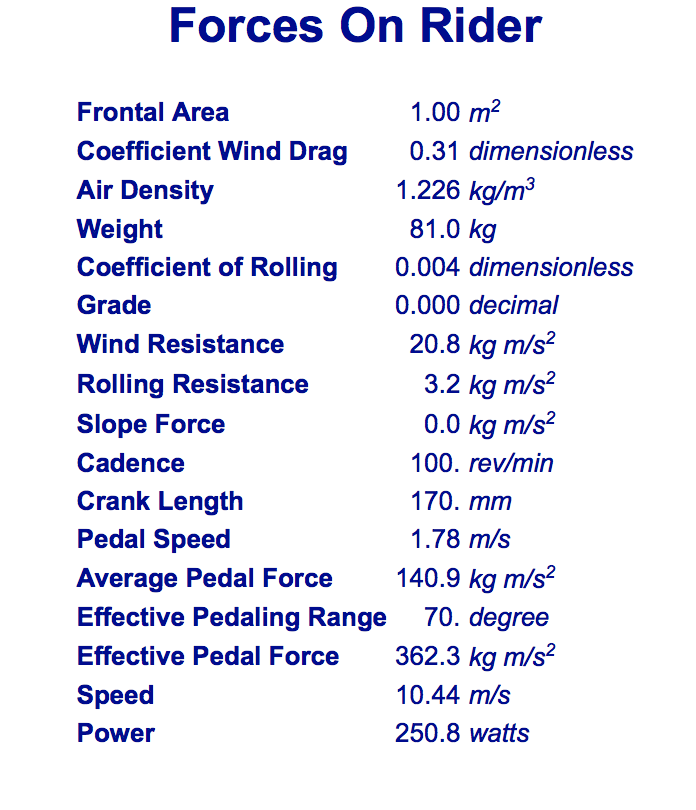

11) One way to check the reasonableness of the CdA is to compare the 6W "error" to the wattage you'd be producing on-the-flats at the same speed. That is, if riding on the flats (where CdA is important), what is your wattage, and what the effect of an 6W error?
I used analyticcycling.com to figure this out. In the highlighted section the bike speed is 10.44m/sec. So, riding on the flats in this ride position the wattage is 251W
Screen Shot 2017-08-20 at 8.47.35 AM.png (139.94 KiB) Viewed 8180 times
Assuming that the CdA "error" is 6W, the PP would measure 251+6=257W. This is an error of 2.4%, well within the measurement accuracy bounds of PP (or any other DFPM).
So, the coast-down estimate of your CdA is 0.312, a bit lower than the 0.328 that comes from PP setup.
What is the overall effect of this change? Your average watts for this ride file, at CdA of .328 was 141W; at .312, 137.9W.

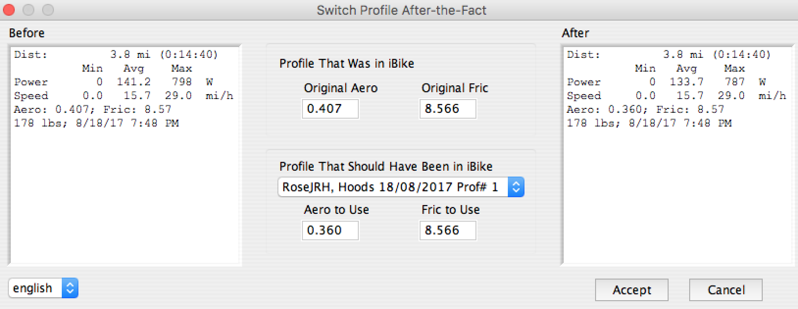

Switch Profile After the Ride does a better job of CdA calculations.

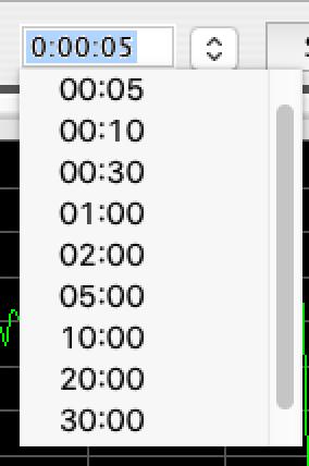

How do I do this?

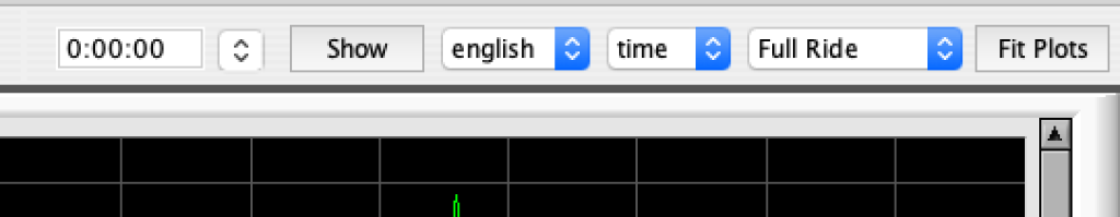

Re: Possible to test Cda with high-speed roll down?
In Isaac, in the top right of the main screen
Screen Shot 2019-01-22 at 4.02.44 PM.png (19.73 KiB) Viewed 7407 times
Screen Shot 2019-01-22 at 4.02.55 PM.png (25.83 KiB) Viewed 7407 times

When I do a coast down, why am I not able to bring up the power values up from zero using the "change profile after the ride", but I am able to do this with "tweak CdA etc.." function? In the discussion above, I see that the preference is given to the latter because it is supposed to be more accurate. I am also seeing braking unless I raise CdA with "change profile after the ride" to an unreasonable value. This is also better fixed with the tweak function. I will post the raw untweaked files. This is on my heavy Surly with two full rear panniers. Weight was updated just before I rolled out.

Update: I see that the AP re-calibrates after every profile change, and it looks like there was not enough time for it to recalibrate in the short ride posted above. I rode to my second job, a long 15mile climb to the college. Difference between DFPM and AP total work is now less than 1%. A lot of work to get it that close :D
