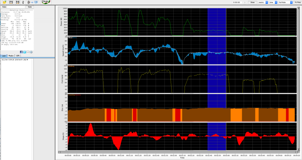

I've attached the profiles for all three bikes, Road, Cyclocross, and MTB, along with my latest road calibration ride on the cyclocross bike.

There was only one ride file attached (the other ride file attached was a duplicate of the first) so I can comment only on that ride file. If you have more ride files, from other bikes, that you'd like me to look at, either post them or email them to me at jhamann@velocomp.com
Also, you attached only one profile.
The ride file you posted indicates a solid calibration. So, I have no reason to believe your setup is wrong.

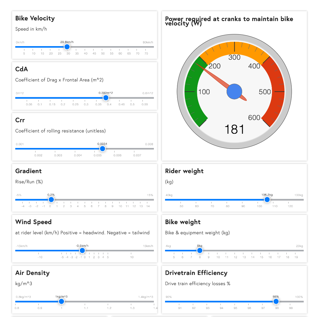

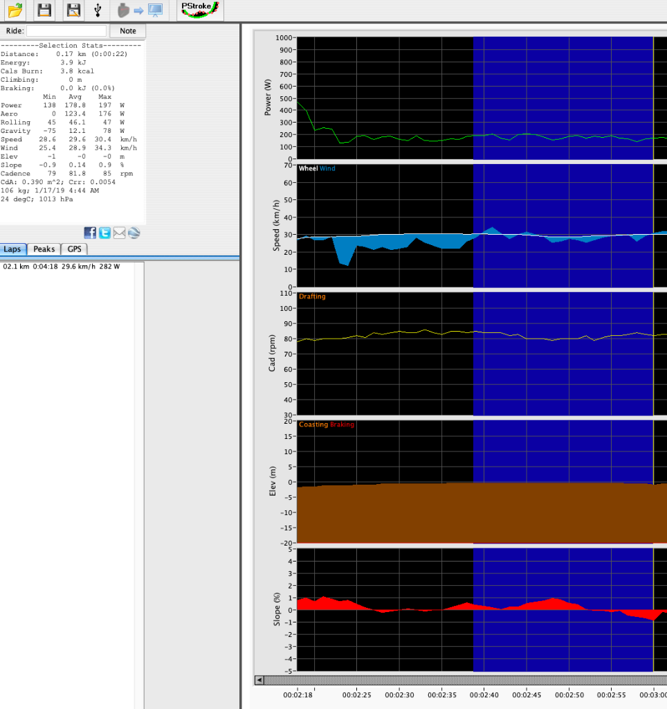

This is only a very short ride (4 minutes) but it includes enough to do an independent check, using this website: http://www.aerocoach.com.au/power-from-speed/.
Basically, I select a section of ride where your parameters are nearly constant (speed, wind speed, slope) and load them into the website. I check to see if the website results are close to PP measurements.
For the section of ride I chose, PP reads 178.8W and the website reads 181.0W. Extremely close...
You were "on the bike" during this entire ride: if you were riding on the flats (as the data suggests), if you weren't battling much ground wind (as the data suggests) and you were riding at a constant speed of around 30km/h (as the data suggests), and your height and weight parameters are correct, then I have no reason to believe PP data is incorrect.
So, if you did an FTP test on this bike, with this profile, I would have see no obvious reason to disbelieve it.

It is only 4 minutes long.
During the first 2 minutes your PP was recalibrating the accelerometer (your PP mounting angle changed from its prior ride). Because calibration was off, during the first 2 minutes the watts there were way too high. This skewed your average watts for the entire 4 minute ride to 296W.
In the final 2 minutes, where calibration was correct (and where I analyzed your file) average watts were 165W. This seems to be in line with what you are expecting.
