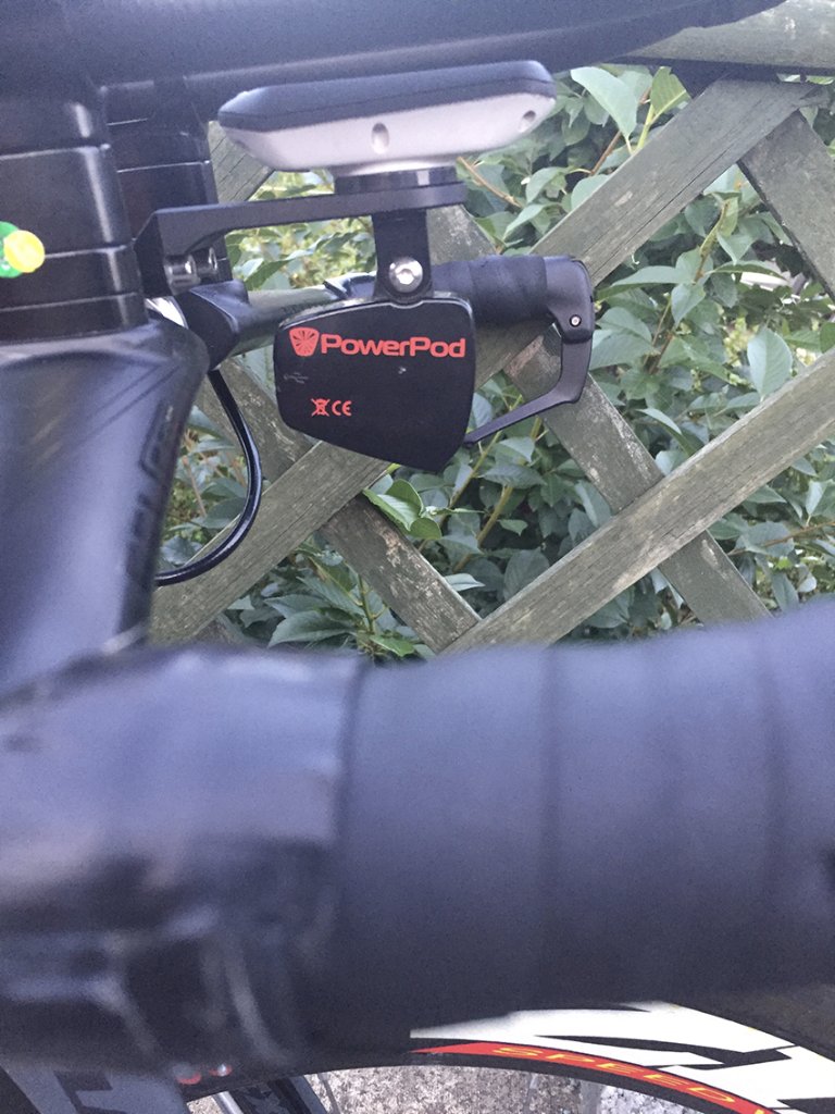

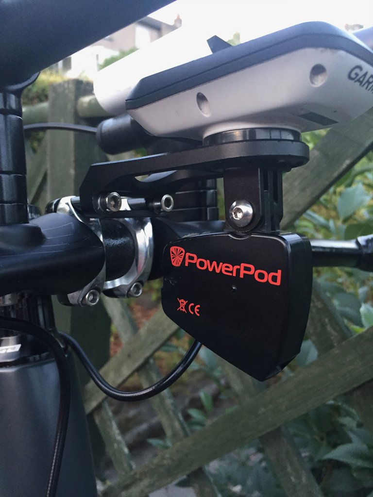

Please post photos showing how your PP is attached to your bike: front, side top and bottom views.

Will post some pics later... but i know that the position is spot on. It is a solid mount with nothing blocking the port, no movement with the Powerpod... it is the same mounting i've been using for a year now. Just the last couple of so of TT's i've done the figures have been fluctuating and spiking.

Hi...
Here are the pics as promised also the file from last nights TT... still very spiky.

Re: TT Bike Calibration question
I'm concerned your mount is not stiff enough.
You might want to get one of our new under-the-bars TT mounts. It is rock solid stiff and will work with your aerobars.

Hi John
It did cross my mind... it seems stiff but any vibration could i guess screw with the settings. I have no issue at all on the road bike which uses a K-Edge out front mount... so it is pointing to that.
