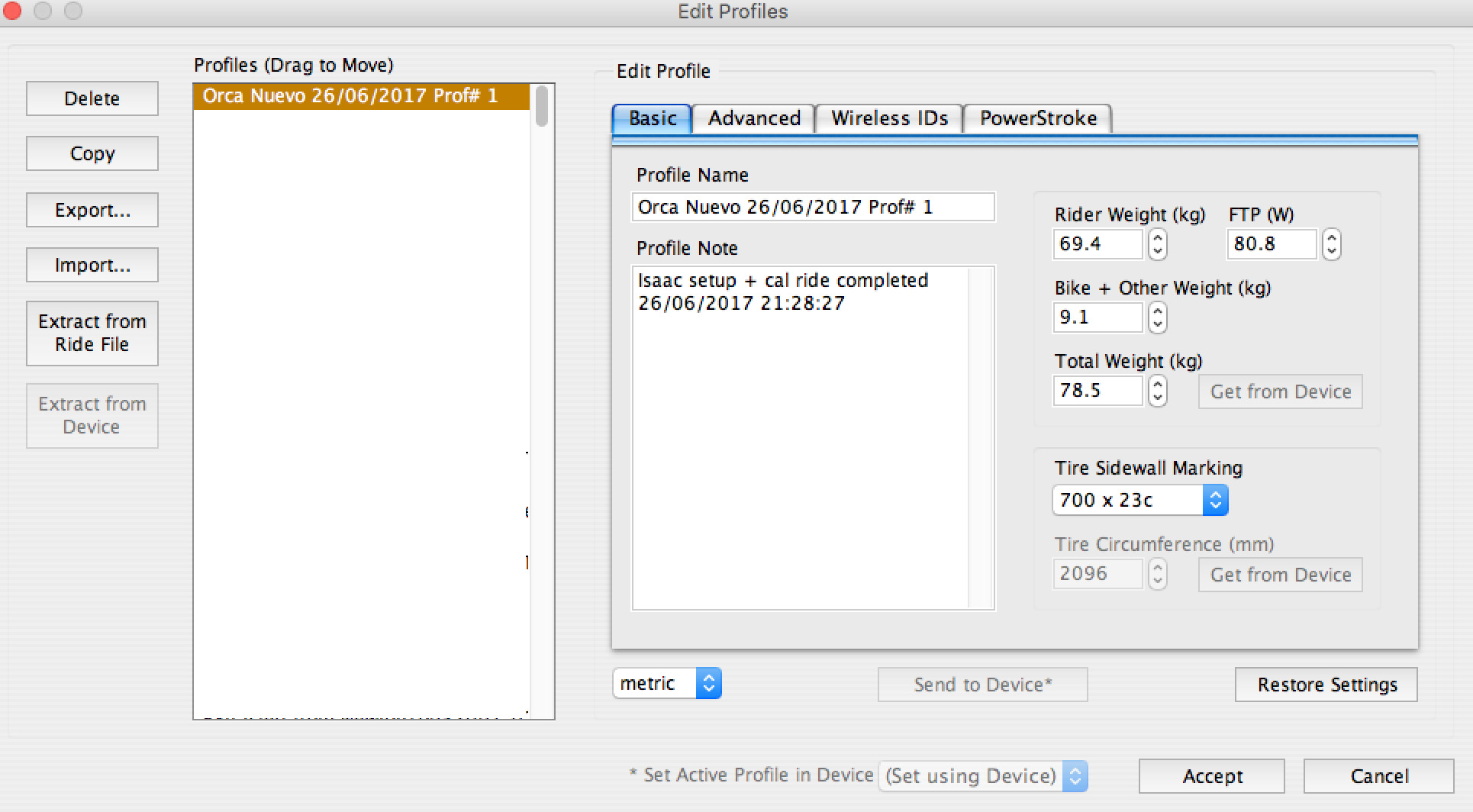

I changed the weight of the cyclist from 70.4 kilograms to 69.5 kilograms. I have done it in the following way since Isaac:
- EDIT
- EDIT PROFILES
- Change weight ACCEPT
- DEVICE
- SEND PROFILE TO DEVICE
- SEND TO IBIKE
As I have done, is it correct?
I would appreciate it if you consulted the file to see if everything is correct, since I had the feeling that in favorable or downhill terrain I had few watts, even some zeros giving pedals downhill.
Thank you

Re: CHANGE OF CYCLIST WEIGHT
Here is how to check:
1) Open your ride file in Isaac
2) Select "Edit/Edit Profiles" from the menu
3) Click the "Extract from Ride File" button at the left of the window
4) Your profile will appear in the window, highlighted
5) Click the "Basic" tab
6) Make sure "metric" is selected near the bottom of the window
7) You will see your rider weight in KG. As you can see, you did things perfectly!
Your PP is well calibrated, too.
You're all set!
