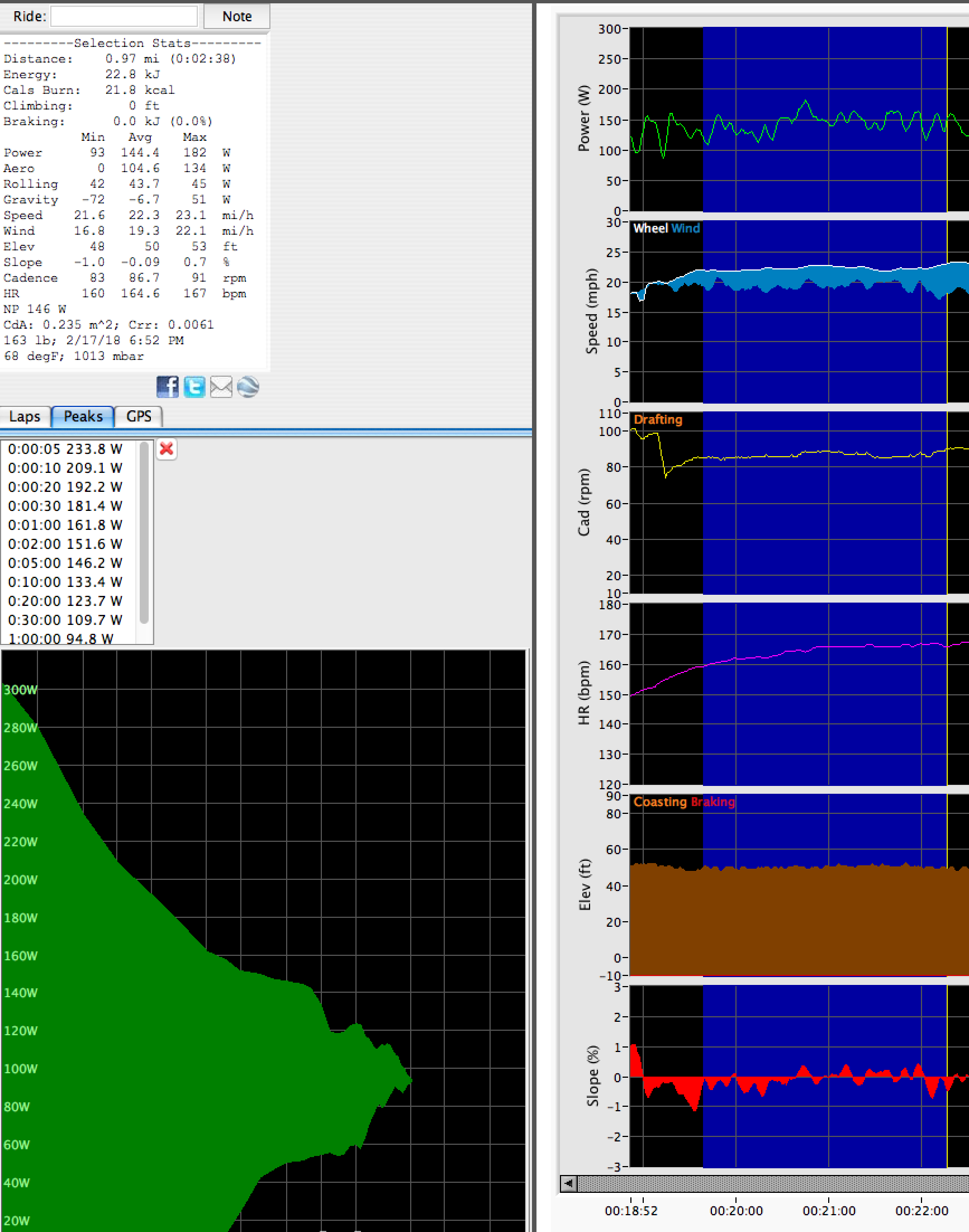

Re: PowerPod Calibration First Time
Your TT ride looks correct. I compared PP readings to bikecalculator.com
Your road bike looks like you were in a group ride. Is this correct?
Screen Shot 2018-02-19 at 11.01.38 AM.png (1.02 MiB) Viewed 3688 times
Screen Shot 2018-02-19 at 11.02.07 AM.png (330.29 KiB) Viewed 3688 times
Group rides are much less difficult than solo rides.
If you want to compare watts to your smart trainer, then you need to do a solo ride.
