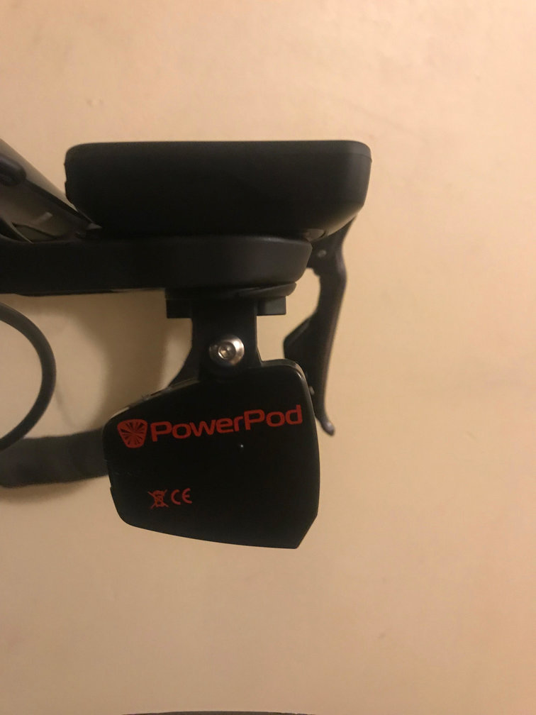

Re: Calibration Mode - Steady Yellow - count 1 to 100
Please post a photo showing how your PP is mounted on your bike. Side view is best

Sure, there is.
- rsz_1unnamed.jpg (62.16 KiB) Viewed 6110 times
Your PP may be pointed too high.
Please reposition your mount so that the word "PowerPod" is approximately level (+/- 20 degrees).
Then, reset the unit and do a new calibration.
Please post the ride file
Now works perfect, why it was in that position, because of the video, i've push it from back util it doesn't move.
So finally the solution for this is always align the powerpod printed letters to ground level with 20 degrees more or less.
