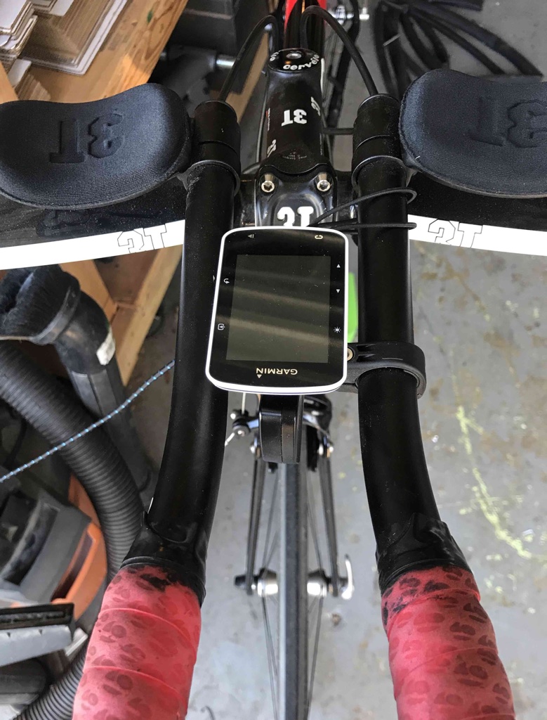

I've had the PP now for about 6 weeks and have really been finding it useful for analyzing my rides. The instant data (I'm set up for 3s avg through my Garmin 520) helps me to pace better on climbs and has consequently improved my overall performance. I just mounted the powerpod to my TT bike's aerobats using a Bar Fly 4, and discovered that the angle of the aerobars does not allow the PP to be perfectly parallel to the bike's lines. Here's a photo to illustrate. Is this okay? The Bar Fly doesn't allow micro-adjust the angle, so how have other's solved this problem, if it is a problem?
Powerpod dual mounted on aerobats with BarFly 4.
powerpod TT placement.jpg (255.19 KiB) Viewed 4243 times

Re: TT Bike Dual Mount angle and power into the wind
It looks like everything is OK. Your wind speed looks solid, and you've set your bike for TT ride position.
I can't tell the angle at which your PP is mounted (side view is necessary) but I don't see any problem in the data, so I don't think you have to try to change anything.

Thanks for looking over the files for me. I think that the PP is level to the ground, I was concerned, though, with the angle relative to the top tube when looking down from riding position toward the ground. Essentially, when I am going straight, the PP is pointed slightly to the right.
briarandbrine wrote:Thanks for looking over the files for me. I think that the PP is level to the ground, I was concerned, though, with the angle relative to the top tube when looking down from riding position toward the ground. Essentially, when I am going straight, the PP is pointed slightly to the right.
That will not be a problem.
Post by briarandbrine »
Great to know. Thanks so much for the response. Now, time to stop typing and go ride...
