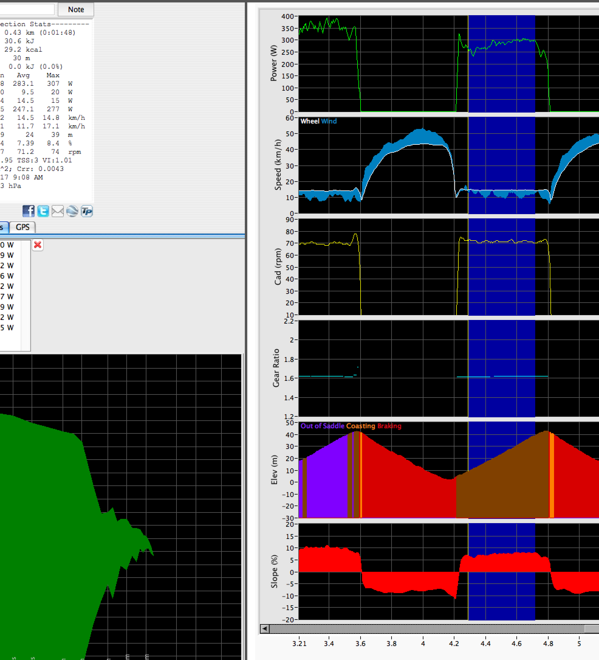

Re: Still not confident regarding accuracy
Bike calculator apps like Gribble use inputs such as speed, slope, rider weight, etc. to compute power.
To use these apps properly you have to be very careful to feed them data consistent with their assumptions. The critical assumption in these apps is that the numbers you input are unchanging.
On the interval you showed below, there is a significant decrease, then increase in the slope of the hill during the climb. Similarly, speed drops, then increases, then drops. These changing input parameters are inconsistent with the app's critical assumption, so the app's power analysis won't be correct.
What I did is use your interval, but selected just the portion of it, where slope and speed are relatively unchanging. Basically, this is the first slope "bump" of your interval. Your reported slope is a pretty constant 13.8%, and speed is a pretty constant 14.1KM/h. I also entered the appropriate values of weight and wind speed (note: at these low bike speeds, wind speed is pretty irrelevant).
Your bike speed is low, which as posted above, can create inaccuracies for bike acceleration measurements. However, because the section I selected has almost-constant bike speed, your bike acceleration in this section is nearly zero. This means that the accelerometer's measurement is driven almost completely from hill steepness. So, PowerPod slope measurement can be pretty accurate.
I used my favorite program, bikecalculator.com (it allows for CdA adjustment) but I'm sure gribble would produce similar numbers.
The result? bikecalculator.com: 502W. PowerPod: 495W
I am very confident that, if you had a DFPM on your bike, you'd get results nearly identical to your PowerPod.
I'm beginning to wonder if the "real" problem here is that you are a much stronger cyclist than you might think! :-)
Screen Shot 2017-08-11 at 6.48.26 AM.png (1.02 MiB) Viewed 27622 times

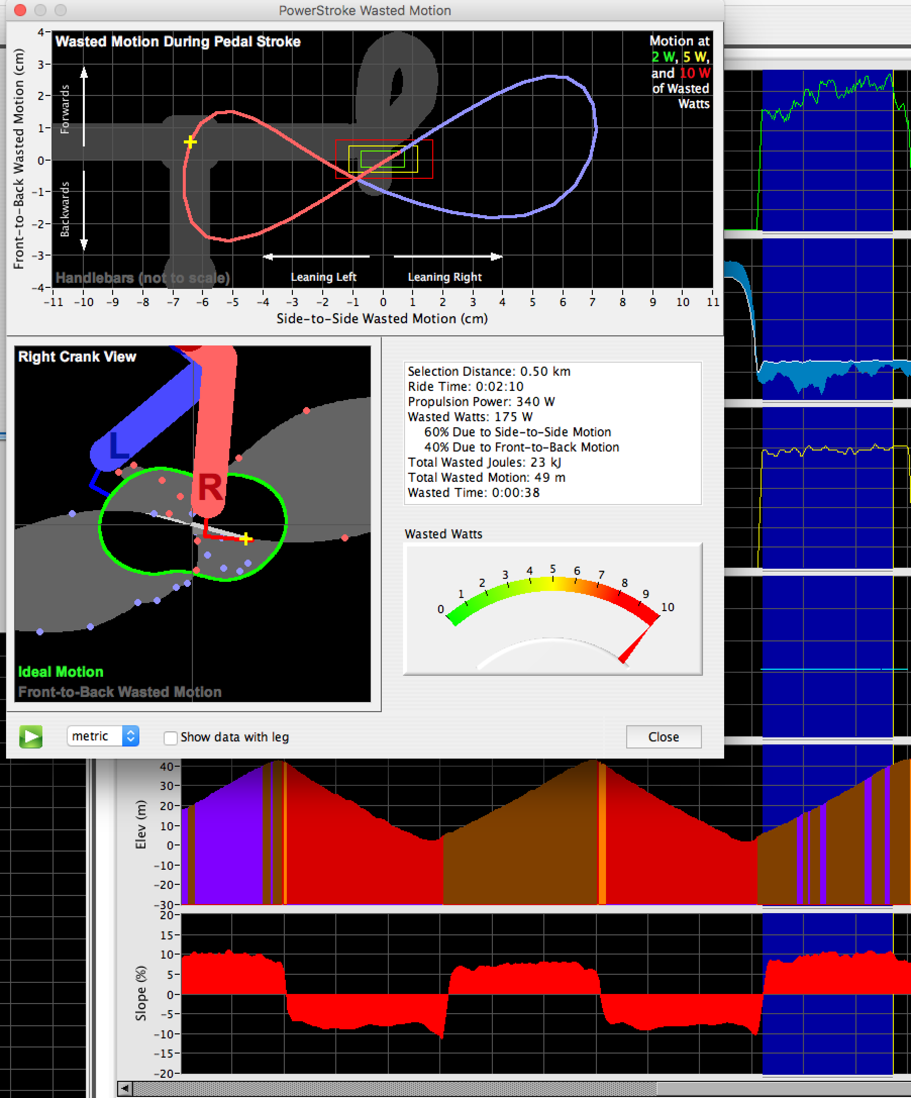

To illustrate the point about apps requiring constant values for the section analyzed, I had a bit of fun.
I selected a place with an uphill, then downhill, for equal distances.
On this section, average slope is about -0.13%, and average bike speed is 20.5 km/h There is a slight tailwind of -0.3 km/h
PP reports 153W for the section, but bikecalculator reports only 61W. Why the huge difference?
The app assumes that speed, slope and wind are unchanging. It gives the "right" answer for these assumptions.
The app has no clue that there is a big climb, followed by a big descent. It has no idea that bike speed is much greater on the downhill. And it does not know there is not any pedaling on the downhill section.
So, the app is wrong...not because it can't do math properly, but because the data was fed with data inconsistent with its assumptions.

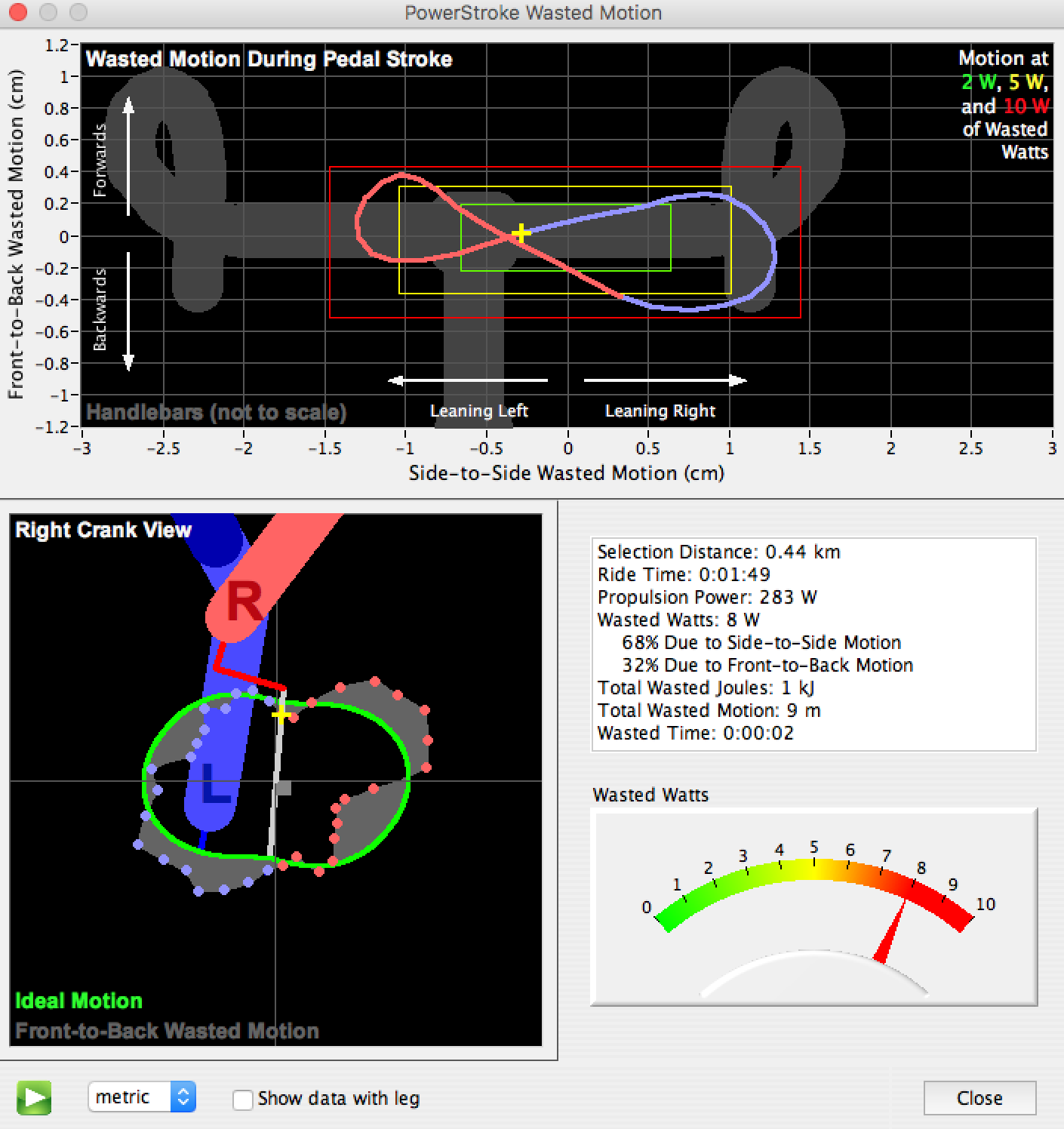

1) In the saddle, your PowerStroke looks good: 3 cm side to side, 1 cm front-to-back, 8 wasted watts
In-the-saddle PowerStroke
Screen Shot 2017-08-13 at 2.51.25 PM.png (209.4 KiB) Viewed 27449 times
2) When out of the saddle you have a huge 14 cm side-to-side sway and 6 cm front-to-back sway; honestly, the largest sway I've ever seen in a ride file, by at least a factor of 3.
Hill 3
Hill 3
Screen Shot 2017-08-13 at 2.24.53 PM.png (362.01 KiB) Viewed 27449 times

3) When using PP for slope measurement comparisons, it is extremely important to pick locations where the slope is not changing, and where bike speed is constant. You have some good data available that satisfies both conditions. You can see a clear break (reduction) in watts near the top of the hill. This is where slope goes down slightly. However, for the prior 430 meters, slope is nearly constant, and you've done a great job of holding constant bike speed (no bike acceleration effect). So, this section of the hill is perfect for slope measurement comparisons. (The data in hill 1 is OK, but nearly perfect for hills 3 and 5). Of course, the out-of saddle data on hills 2 and 4 is not used... :-)
Out-of-saddle PowerStroke
Screen Shot 2017-08-13 at 2.09.13 PM.png (320.91 KiB) Viewed 27449 times
For your three, In-the-saddle efforts (hills 1,3 and 5), PP measures:
Hill 1: 30 m climb, a 7.57% slope (note there is some bumpiness in watts near the top of the climb).
Hill 3: 30 m climbed, over a distance of 430 m, or a 7.39%. Very smooth watts
Hill 5: 30 m climb, 7.38% slope. Very smooth watts
Hill 1 has some variation in watts near the end, but hill 3 and 5 are very, very smooth. So, for PP, I've used 30 m rise (from baro sensor), 430 m length (from speed sensor), and 7.385% slope (from accelerometer, hills 3 and 5)
Using the baro sensor and speed sensor data, you climbed 30 m over 430 m, which yields a slope of 7.0%, somewhat lower than the 7.385% slope measured by the accelerometer.
But here's the thing: if the distance climbed were measured to be 31.7 m, instead of 30 m, PP and baro slopes would be identical.
For baro elevation readings to be precise, the pressure inside PP case needs to be identical to the outside pressure. Under conditions of rapidly changing pressure (which happens on any steep climb), it takes about 5 seconds for internal and external pressures to equalize; consequently, the baro sensor elevation will lag behind actual elevation changes.
You climb 30 m in about 107 seconds. Each 5 seconds you climb about 1.4 meters. So, what may be happening here is that the baro elevation/slope readings are not updating fast enough to keep up with the accelerometer slope readings.
