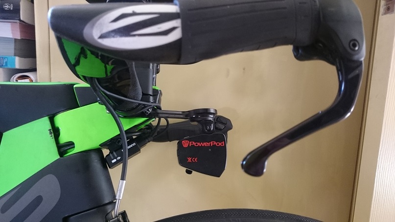

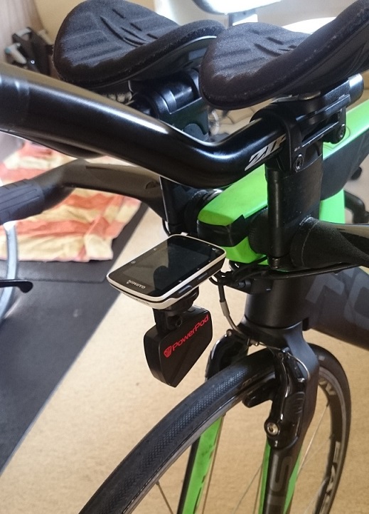

Anyone know what is going on? I have also attached mounting to the TT bike.

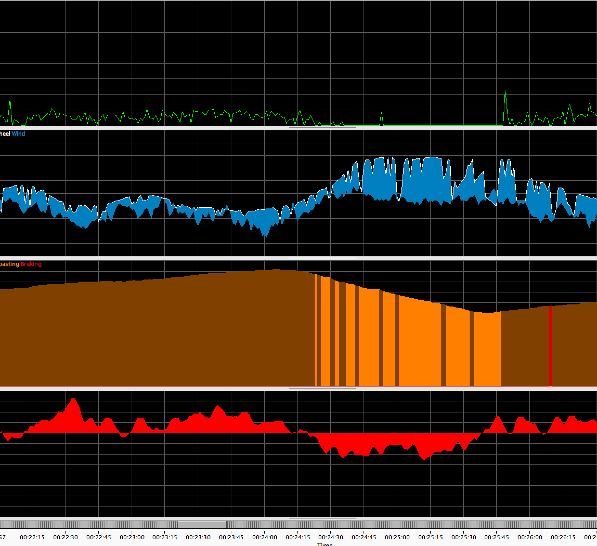

Not been riding the TT much. Had the Wahoo speed sensor warranty replaced, mounted on the front wheel. Took it racing today and still having the same issue. The power numbers coming from the powerpod are all over the place and the distance measured by the powerpod is a couple of km less than it should be. The raw data file attached. Tweaking the cda/scaling etc doesn't help as the distance is almost 10% out.
Maybe it is the wheel sensor fault again, or maybe it is too noisy as you say. I don't really want to spend more $ on another wireless wheel sensor for the problem to persist.
How can I verify its the wheel sensor and not the powerpod? If the wahoo sensor was dropping the occasional pulse then you should see speed halve every now and then. When I zoom in on the speed it does look a bit noisy, but I dont see the speed going from 40km/hr to 20km/hr then back to 40km/hr. Shouldn't the powerpod smooth this speed measurement out anyway?

Re: Isaac software will not alter tyre circumference - why?
Sorry to say, the speed sensor is showing lots of dropouts. When the signal drops out, PP thinks you're not moving, so the distance does not increase. This is why your total distance is a bit short.
Do you have this sensor mounted on your front hub?
I would try the Garmin speed sensor. I know it is an expense, but in our experience these sensors work properly.
