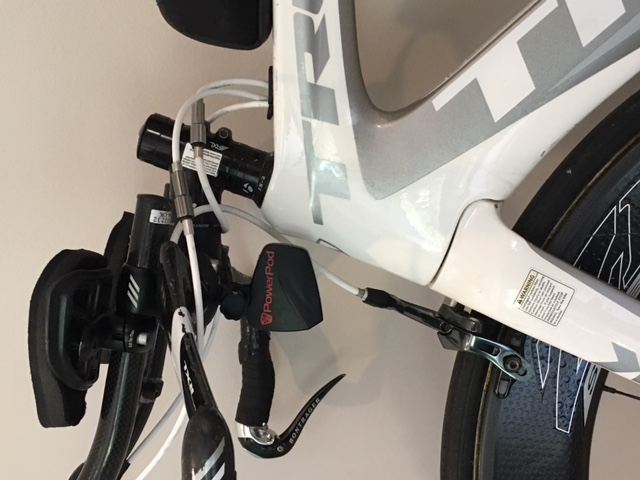

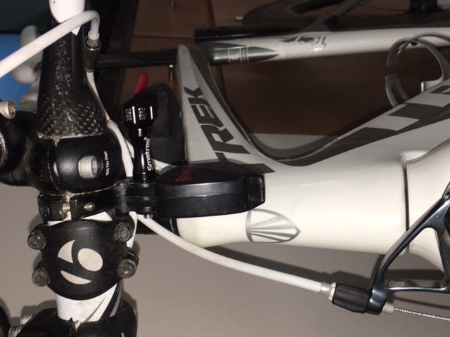

1) Post side, front, top images of your PP attached to your bike. The word "PowerPod" should be approximately level to the ground beneath it. If it is sufficiently angled, this could be the cause of your problem.

1. Side and front photos are attached. From the top you can see nothing since the PP is below the aero bars. It appears to me to be level with the ground.

Here are the photos
- Side 2017-05-31 13-19-04 -0500.jpg (98.68 KiB) Viewed 4807 times
- Front 2017-05-31 13-19-46 -0500.jpg (90.85 KiB) Viewed 4807 times
