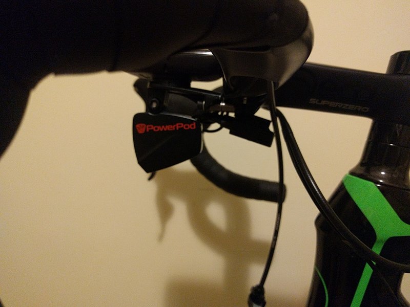

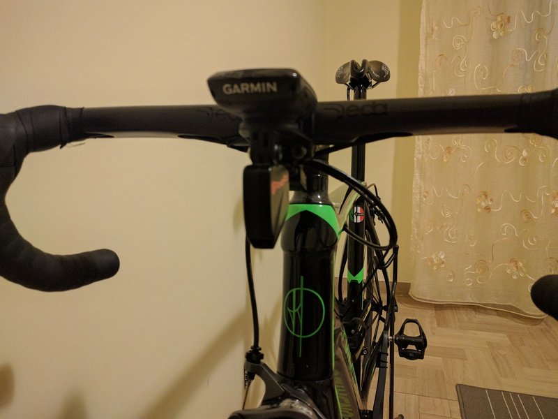

Please post a side, top and front view showing how your PP is attached to your bike.

Ok, John when come back to home I will post the photo. However, the PP is positioned on the central Garmin combo bracket, It has no forward cables and the word powerpod is perpendicular to the ground

John, file and photo posted....

Please contact technicalsupport@velocomp.com for next steps. Your wind sensor appears to be behaving improperly.
