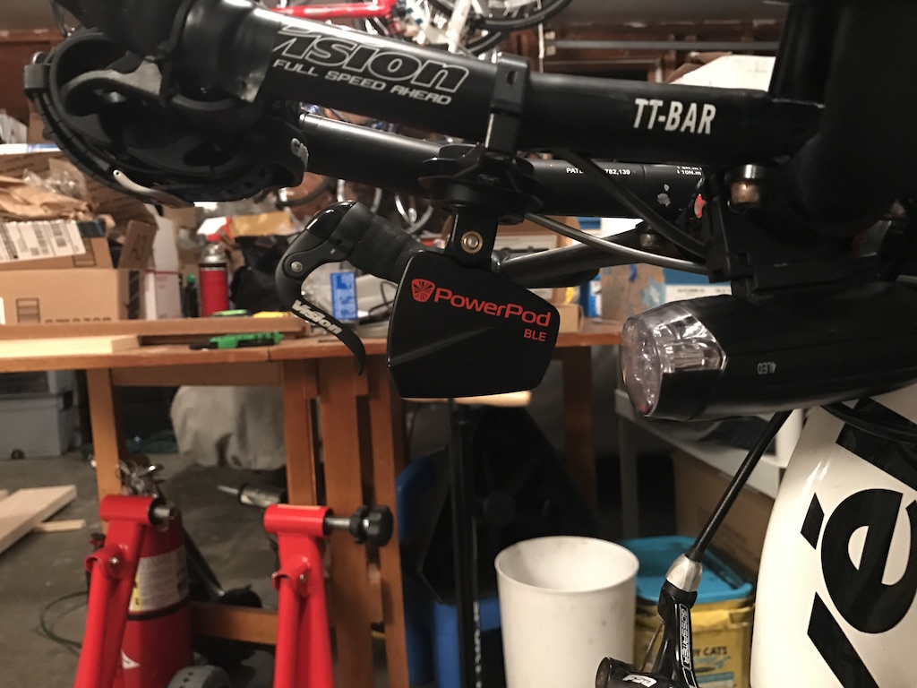

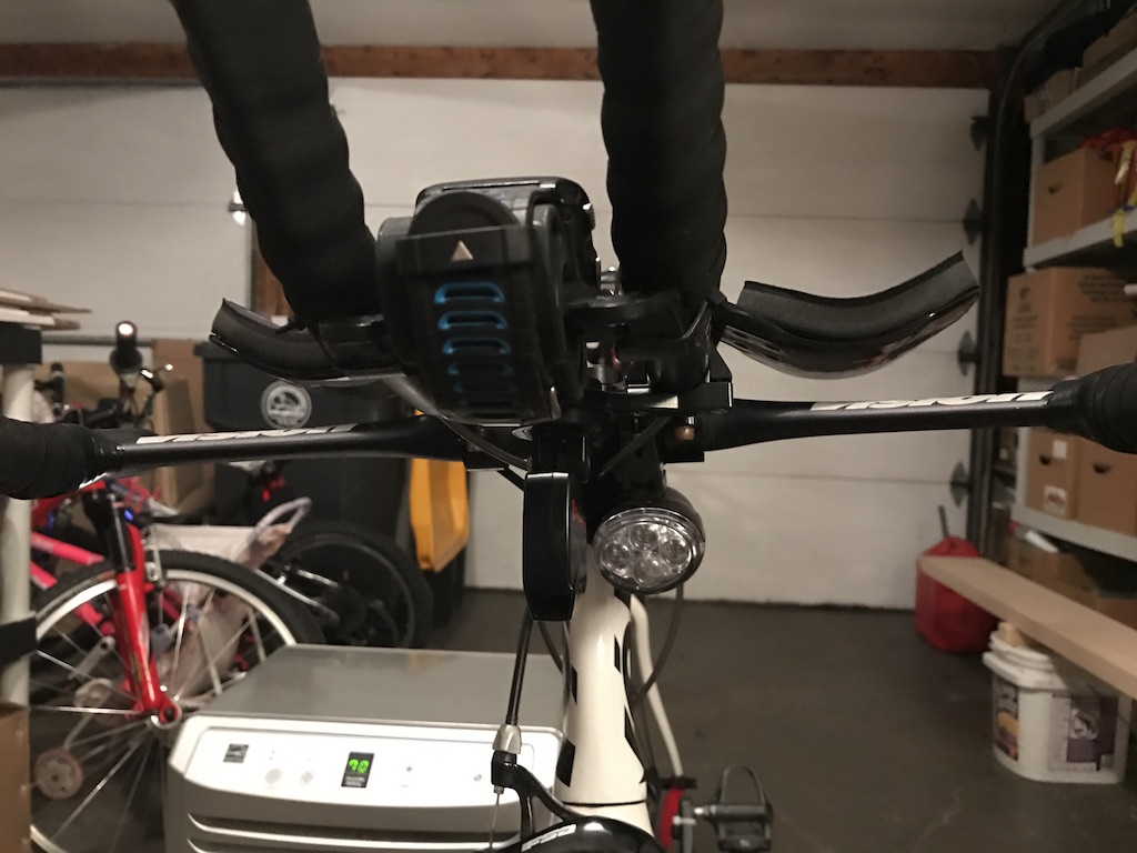

In case it's helpful, I attached a few images showing my cockpit and how I mounted the PP. I reversed the combo/TT mount to put the PP a little lower since I have my Garmin watch mounted out in front on a custom watch mount, and I thought this may be important to prevent an effect on the PP from the watch.
Does this look ok?
Thanks!!

Re: New user calibration check for TT bike
Your PowerPod is angled too high; the word "PowerPod" should be approximately level to the ground.
You can rotate the PP to the "other" stop on the mount. That likely will improve things sufficiently.

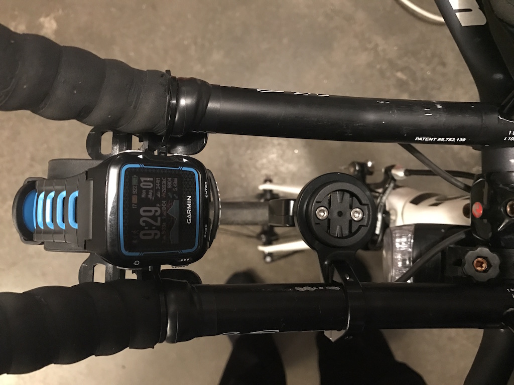

I would mount your PP close to the handlebars, to minimize the possibility of vibration.
Mounting it to the side is also OK, but again, close to the handlebars to minimize vibration.
Hi again,
I mounted the PP out to the side of my TT bars, closer to the handlebars (about an inch forward), and rotated the PP back (instead of forwards) to the stop in the mount. This allowed the writing to be parallel to the ground as recommended.

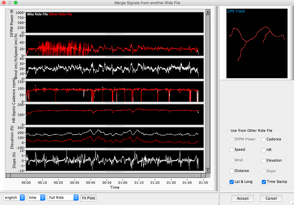

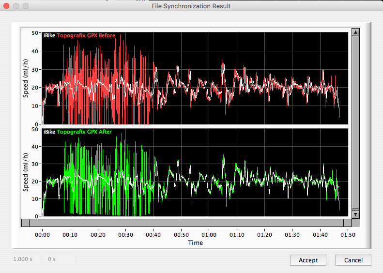

Ok, was able to get out this morning. Ride file attached.
This time was a little different, at first, I felt like the power readings were again low on descents and high on climbs, relative to my perceived effort, which I tried to keep more or less constant. But in the latter half of the ride everything seemed better.
Then, when I merged my garmin/strava data to get the GPS track, I saw that the speed data in the garmin file is really weird for a while, then gets better (see pic below). This section of scattered data seems to correlate with when I experienced the variable power, and then it seems to go away about when I felt the power was more correct. It looks like the PP data is not affected though.
Do you know what is going on and is this something I should worry about? My sensor is a combo/magnet on the rear chainstay (not the GSC-10 that I know can cause problems -- not sure of the make will have to go look).
Thanks again for your help, John!!

Your most recent ride file looks PERFECT!
When GPS data is unreliable you'll get "noise" in the speed signal. This is about your Garmin, not about PP.
