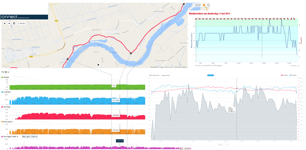

Re: tt-postion and side wind
Thanks for your reply.
I agree with what you say, it's difficult to precisely determine the direction of the wind when on the bike, the feeling you have on the bike isn't always whats rely going on.
I made a little graphic with the relavant information. The weather data I found are from a weatherstation some 10 kilometers to the west so pretty precice. And like you said this pictures the wind not as a pure headwind and side wind alhough I still beleive it was pure side wind. Perhaps the dike I'm riding which is about 5meters high has his influence as well and 10km is far away enough to have a slightly different windsituation.
