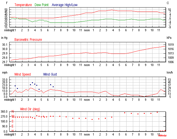

I know one of the downhills was into a headwind, but again HR and PE both seemed like I wasn't working anywhere near as hard as the PP indicated. And I'm pretty sure given the prevailing wind direction (graphs below from weatherunderground.com) that the bump at 21 miles had fairly direct tailwind. But that's not what the track in Isaac is showing if I'm reading the graph correctly.
