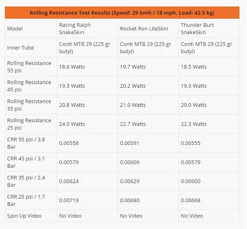

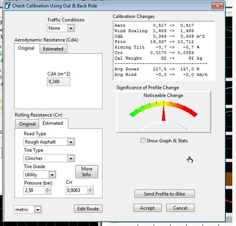

Ok, I think it will be the CRR - rolling resistance setup. Original crr setup was = 0,01701. And what I have find on the internets should be for my tire = 0.00624.
When I tried to put this into the Tweak CdA, Crr & Cm in Isaac, then it gave me more reasonable Avrg. watts.. but I dont know, I am no expert at this at all.
Additionally they have there that the values are measured for (Speed: 29 kmh / 18 mph, Load: 42.5 kg).. http://www.bicyclerollingresistance.com ... eskin-2015
I hope you will bring some more clarity on that for me:) Cheers

Re: MTB settings for powerpod
This ride is well calibrated, but in the last 20 minutes of it there is evidence of your suspension (or PP) moving around.
Make sure things are tight and you'll be OK.
So you mean I should not change the Crr for 0,006 and keep it like it is?

If anyone will read it later or for a future reference - I will change the Crr value in the profile for 0,007, which gave it Riding tilt of -0,7 % and Friction of 11,276.
I will give it a try, but seems more precise than the previous Crr of 0,0170.
