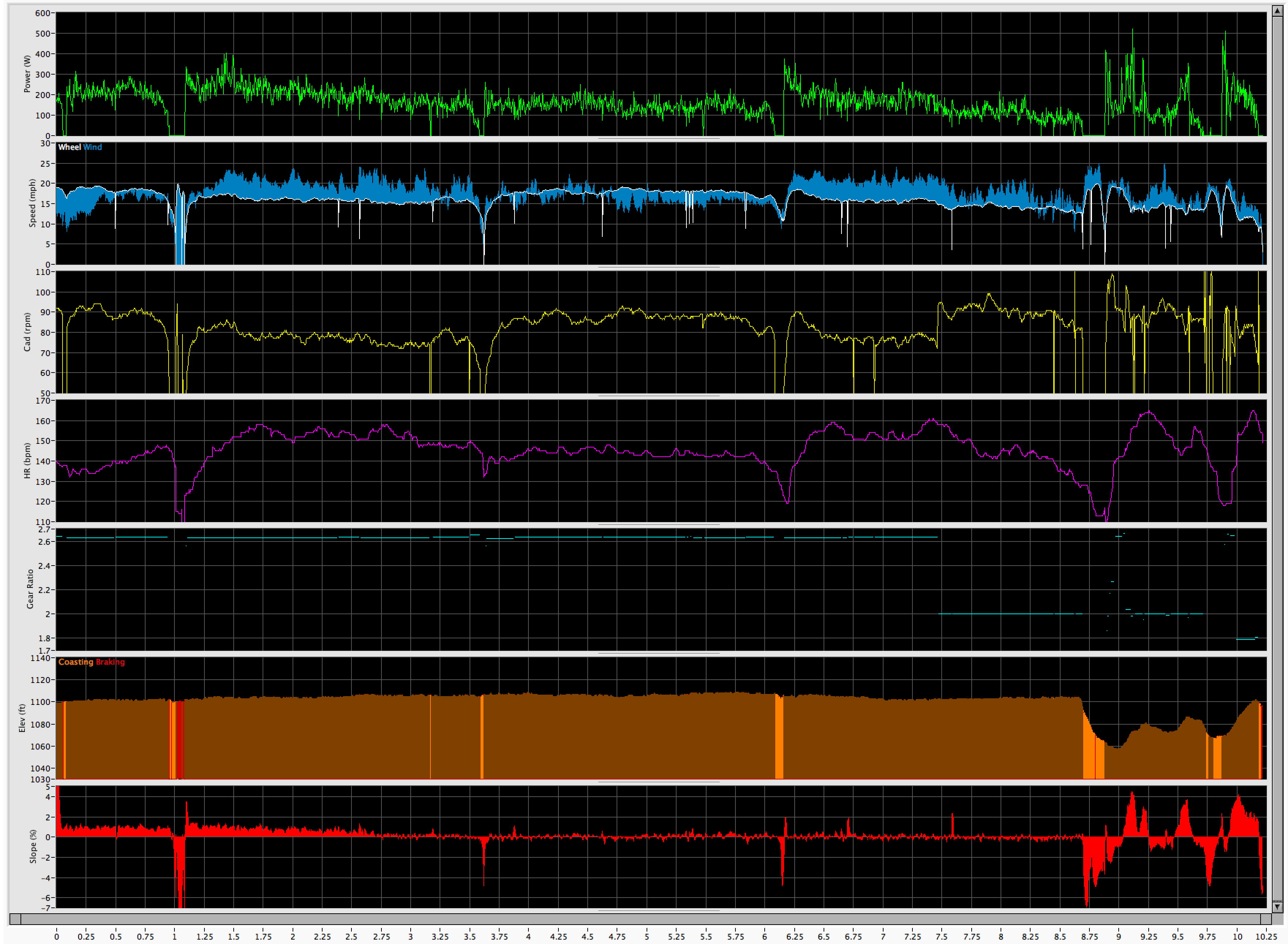

This is my first ride with the PP. Did calibration as described in the instructions. And then an "out and back" ride....Power was all over the place...I could not get a somewhat steady reading at all! Attached is my IBR file...
Please let me know if there is something I need to tweak. Also, you could ignore the last 2 miles (from 8.75 to 10) as I did not start my ride exactly from that point.

It looks like you are using a Garmin GSC-10 sensor, which is old technology and does not broadcast a strong signal. You are getting speed dropouts in your ride file.
You should update to the new, magnet-less speed and cadence sensors from Garmin or Wahoo. They work much better and are more convenient.
Once you have a good sensor on your bike please do another ride and post the results.

Some sensors have better transmitters than others.
Your sensor is showing lots of speed and cadence dropouts. This sensor design looks very similar to the GSC-10...
It may also be related to position of your bike computer and PowerPod on your bike.
The bottom line is that newer-generation sensors work better.

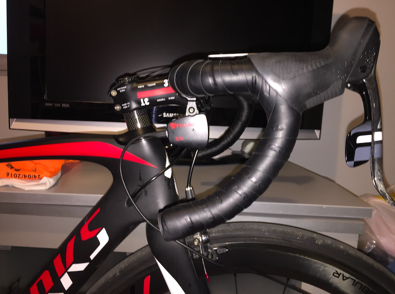

Good day,
I need feedback with my first ride to
I tagged @ridevelocomp in instagram's photo and somebody of your company said me that may be the PP is not correctly mounted because during the calibration it read a pending variation that fix the calibrtion after 8 minutes. I have attached photo of them, please let me know if it's in a wrong position.
I attach too Pics of the bike to can see the position on this, aero elements, etc... As you can see I used aero wheels. They are 55mm profile and 25mm width, with TUFO S33 tubulars 24mm with 7bars each one.
Here you are also the file of the first ride to check and give me some feedback of them
It's really an out and back ride (I started and finished in the same place) , but in the middle of the ride I climb and down twice to the same place, I don't know if this ride file is good to check the calibration.
Please let me know
Thanks a lot in advance.

Everything looks quite good.
If you have your speed sensor on your rear wheel hub I would move it to the front wheel hub.

Thanks John!!Velocomp wrote:Everything looks quite good.
Would yo do other ride out and back to check calibration with isaac software?
Tomorrow I will ride with some friends, I will change the sensor to the front wheel, but my question is. What's the difference between put it on the front or rear wheel??
Thanks in advance
Re: First ride...Need feedback.
Probably a more stable signal as the distance would be reduced.
