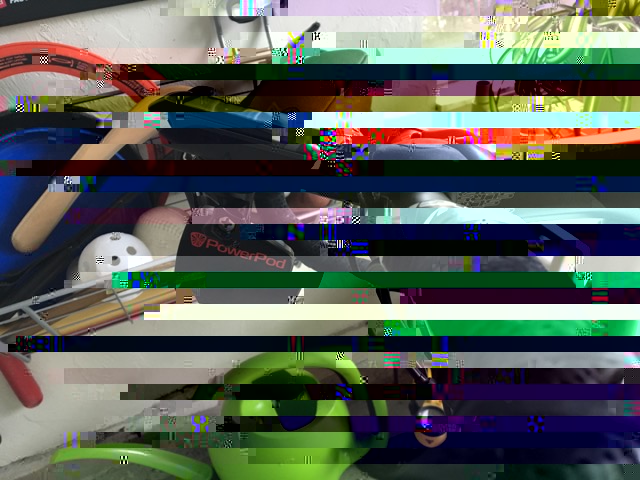

What is happening is that the PowerPod has been pointed too far away from level: in the photo below the PowerPod is pointed too high towards the sky (the Newton is approximately parallel to the pavement beneath, it but the PowerPod is pointed up at about a 30 degree angle).
PowerPod pointed too high
PP_Pointed Too High.jpeg (65.72 KiB) Viewed 2947 times
Here is a combo mount installation, showing the problem of the PowerPod being pointed too high:
Combo mount pointed too high
Combo too high.jpeg (73.77 KiB) Viewed 2947 times
NOTE: The looping problem will also appear if the PowerPod is pointed downwards excessively.
THE CORRECT MOUNTING
The instructions show PowerPod being approximately level (that is, the word “PowerPod” is approximately parallel to the pavement beneath it, that is, +/- 20 degrees from level):
Correct Mounting
Correct Mounting
Correct Mounting.jpeg (64.34 KiB) Viewed 2947 times
HOW TO FIX THE LOOPING PROBLEM
If you have experienced the calibration “looping" problem, here is the very simple fix:
1) Re-angle your mount so that the word “PowerPod" is reasonably parallel to the pavement beneath it (it does not have to be exactly parallel, anywhere +/- 20 degrees from parallel will work).
2) Let your PowerPod rest, without speed readings, for 5 minutes, so that the PowerPod flushes its memory of the previous 5 minute ride data.
3) Repeat the 5 minute ride. This one should work!
