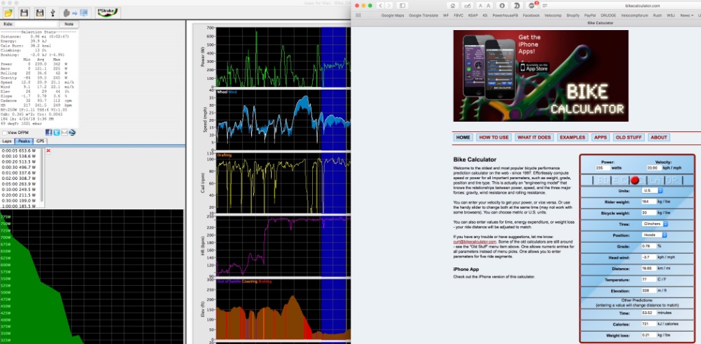

I check these things when I see this kind of question:
1) I look at the overall data to see if the calibration is correct. Yours appears to be just fine
2) I look at measurements on hills, where the accelerometer/weight parameters are most important
3) I look at measurement on flats, where wind sensor/CdA are most important
4) I assume the Velocomp device is providing correct environmental data (speed, slope, wind)
5) I use bikecalculator.com to plug in the hill/flats data
In the flats section, Newton measured 239W, Vector178W, bikecalculator.com 235W (see below)
In the hill section, Newton measured 294W, Vector 255W, bikecalculator.com, 299W (see below)
It looks to me like your Vector is reading low.

- Screen Shot 2018-04-25 at 6.04.02 AM.jpg (160.2 KiB) Viewed 32090 times
- Screen Shot 2018-04-25 at 6.02.35 AM.jpg (160.84 KiB) Viewed 32090 times

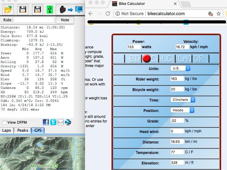

Thanks John.
I get somewhat different results between N6 and BikeCalculator at different points, some differences greater than others, but the net result is the same, Garmin considerably lower.
I am curious about the calculations over the entire ride. N6 reports average 178W and if I plug in the stats into BikeCalculator, it arrives at 133W (Garmin 166W). Different averaging methods?
- Ave.jpeg (92.13 KiB) Viewed 32084 times

You can't use bikecalculator.com for long stretches. Their calculations assume that conditions input are constant--clearly, not the case in the real world for a ride of any length! Think of it this way: in the middle of a hurricane, at any given location, the average slope of the water is zero, no matter how much the seas are going crazy
You'll notice that for the analysis I did I picked out short stretches only, where conditions ARE relatively constant.
