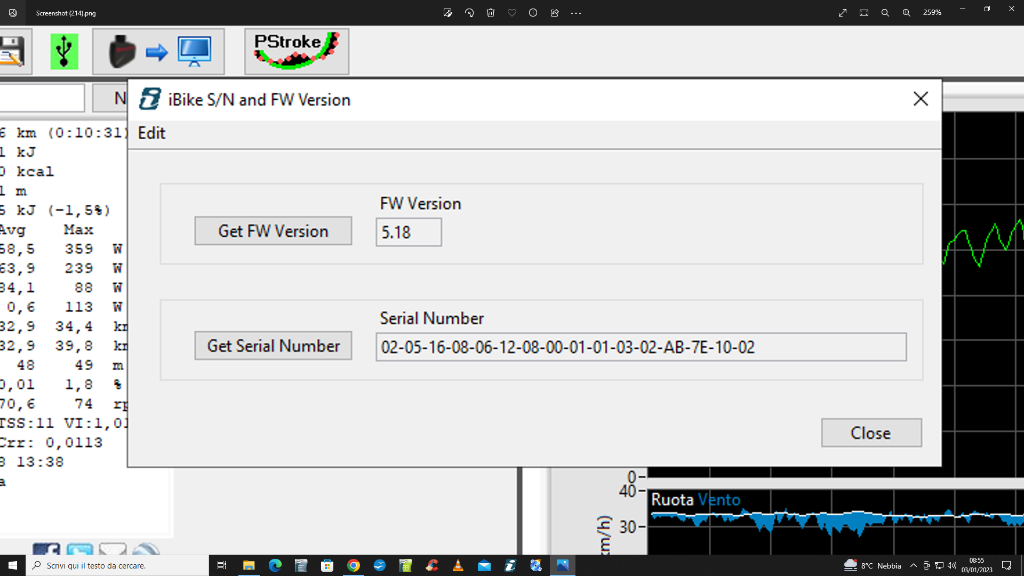

The photo of the serial number is attached.
Let me know...I really need good news

The serial number in your screen shot is difficult to read. Please type it in this thread.

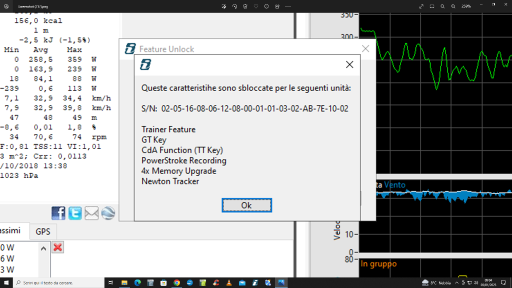

Also, go to "Device/Unlock Feature/Get Unlock Status" and take a screen shot of the features enabled in your unit.

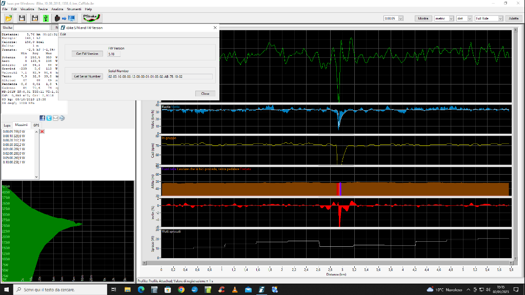

Serial number : 02-05-16-08-06-12-08-00-01-01-03-02-AB-7E-10-02.
Screenshot (218).png (236.79 KiB) Viewed 67897 times
Screenshot (216).png (182.1 KiB) Viewed 67897 times

Good news: you have the CdA key installed, so as long as you do not have a DFPM paired to your Newton, your Newton will transmit its power information to your Varia.
Make sure your Newton is awake and paired to your ANT+ sensors, then pair your Newton to your Varia.
