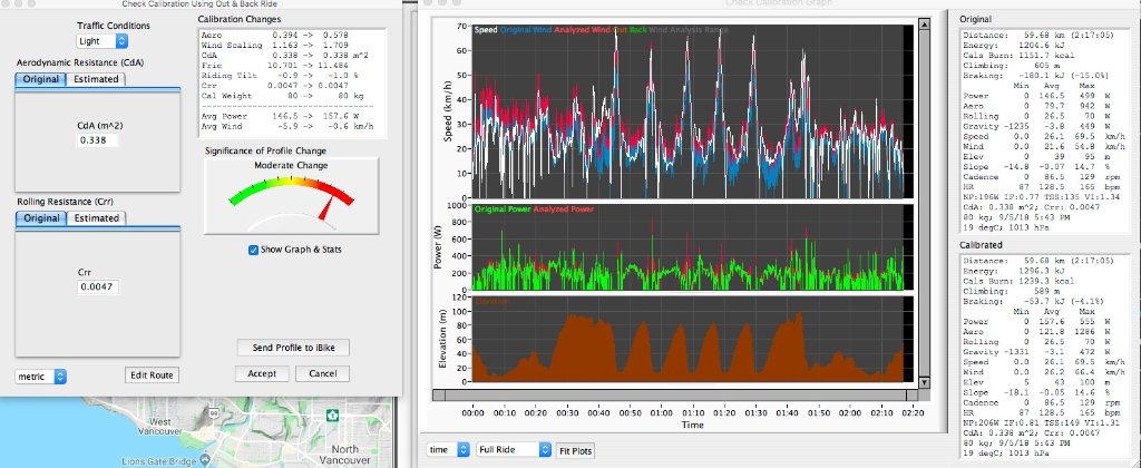

Re: Always a tail wind!
Hi John;
I'm still having the same issue with wind after following your instructions.
This ride had some drafting (7.1%) which I ignored for "Check Calibration".
I did not send this correction the the N6 as I did last time.
- iBike_09_05_2018_1743_59_km_HiDef_AfterCalChanges.ibr
- (1.5 MiB) Downloaded 1772 times
- CalibChanges.jpeg (101.07 KiB) Viewed 73276 times
- iBike_09_05_2018_1743_59_km_HiDef.ibr
- (1.27 MiB) Downloaded 1598 times

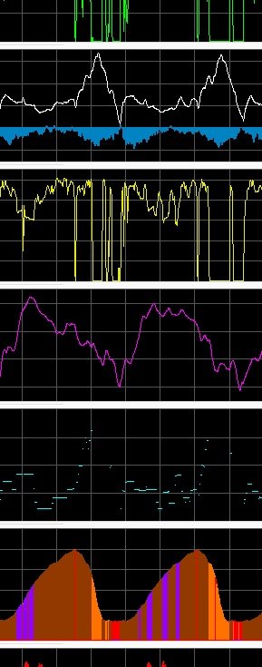

I see the tailwind both up and down the same hill repeat.
It just seems to me that if I have a 7 km/hr tailwind up the hill, I should have a 7 km/hr headwind on the way down in the opposite direction.. No?
- TailWind.jpg (44.16 KiB) Viewed 73270 times
This is tricky
1) Your uphill is at low speed, where wind speed is difficult (and fortunately irrelevant) to measure
2) Your downhill is in the opposite direction, where wind speed can be seen.
3) Your climbs are right at the ocean, presumably where there are breezes
The net of the above is that this is not a good section to use for wind adjustment.
The early (and late) parts of your ride show normal wind speed readings.
I would leave things alone.
