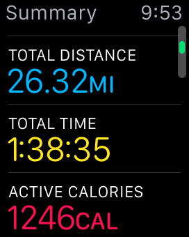

Yesterday I rode with an Apple Watch, which has a heart rate sensor. Since HR changes are somewhat related to energy expended, it seems like the Apple Watch should do better. Well, it did, sort of...the Apple Watch says I expended 1246 calories over a period of 87 minutes of actual riding. That's 247W average.
I WISH!
Apple Watch average watts were "only" 50% high...
