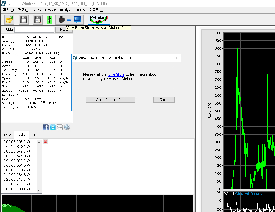

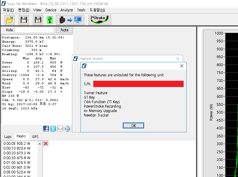

Hello
I recently updated powerpod firmware and issac software latest version.
Riding files after that, every time I launch PStroke analysis, it shows only example file not actual pop-up window.
but when i open riding files before i updated, it shows all waste motion analysis just like before.
do i need to unlock feature again?
Thank you~!

Please post a .ibr ride file that illustrates your problem.

Posts: 7946
Re: Firmware upgraded problem...
PowerStroke requires cadence data.
The problem is that your cadence sensor ID is not stored in your profile.
Do a new pairing with your PP, making sure first that your cadence sensor is definitely ON. Ride around a bit, until you see your cadence data on your Garmin, then do a pairing.
After that you should be OK.
