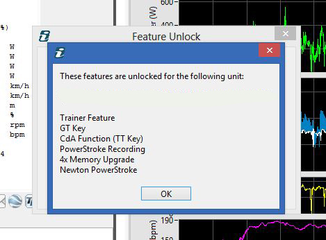

I have just purchased the powerstroke upgrade for my powerpod in blackfriday deal. After going through the instruction i have installed the Powerstroke upgrade key which was sent by Mr.Tom Gore into my PP and when i access the Device > Unlock Feature> Get unlock status , I get this screen saying Powerstroke is installed
So i know it is installed...But it says Newton powerstroke and not powerpod powerstroke is it ok? I am asking this because i happened to see a Powerstroke upgrade only for newton listed in website. so i wanted to be sure.

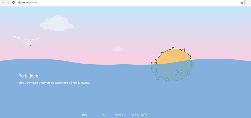

I went ahead and read the instruction in isaac regarding powerstroke and it only lists the powerpod instruction pertaining to newton and not on powerpod. I also tried to access the video on the powerstroke upgrade page for powerpod but the site it gets directed says its forbidden. enclosing a screenshot
