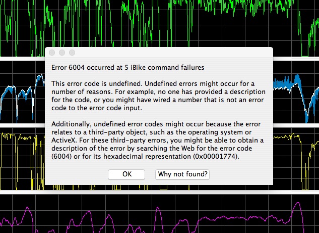

I had my Newton 6 froze after I saw an error alert (6004) on launch of Isaac 4.0.0 and FW update to 5.13
I can't hard reset (up, centre and down buttons).
Suggestion?
I've attached a screen shot of the error message.

Any comment on the error code and freeze. Are they related or just random co-incidence?
Posts: 7946
Re: Newton 6 frozen - no hard reset
I'd try downloading the file again. If you still get the error code, then the ride file is corrupted (sorry) and you should erase the data from your Newton.
