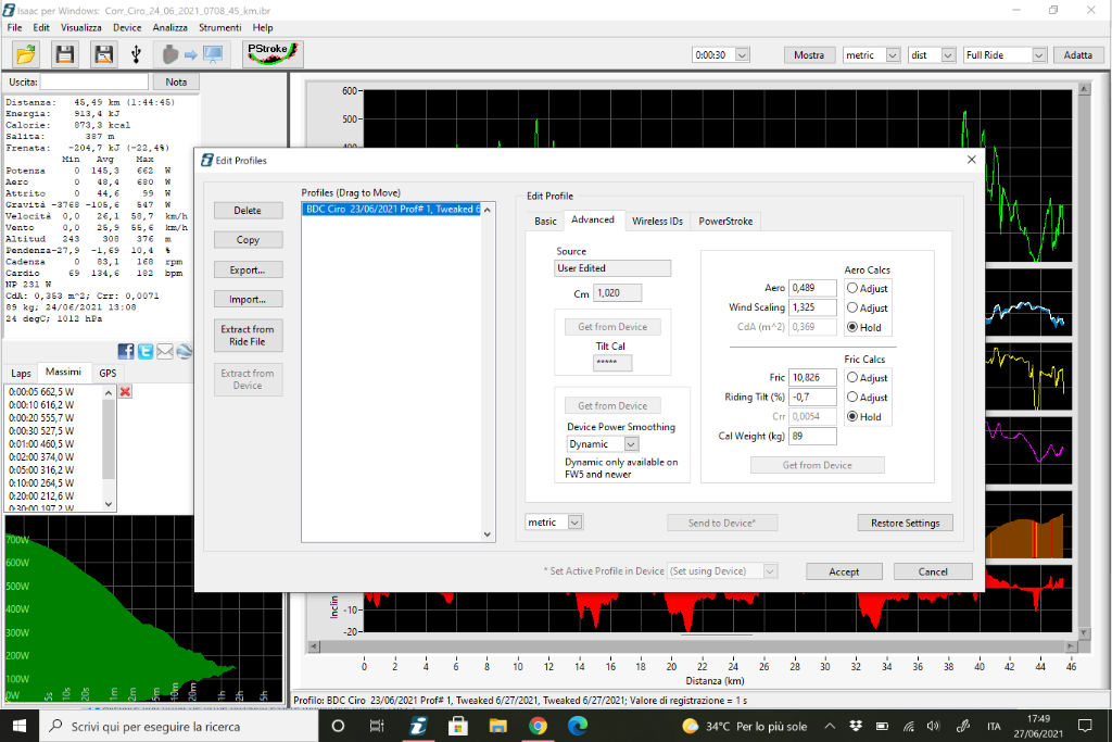

I think I will have to do the calibration again, the power is still too high.
Do you advise me to do a hard reset first?
Newton_Ciro_01_07_2021_1810_42_km.ibr
(329.02 KiB) Downloaded 873 times
Screenshot (6).png (254.06 KiB) Viewed 33076 times
Re: The Newton looks strong
At the 35 minute mark, either your mount changes angle or you are riding in a really bumpy patch of road.
Make sure your mount is solidly attached and can't rotate.
Also: your Newton is 9 years old. We've improved a lot since then and it's possible your unit is past its best days.
