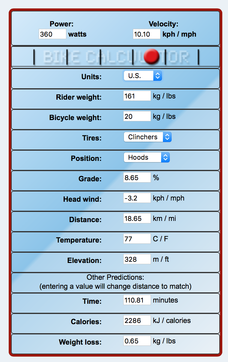

The first part of the climb is where there is a significant difference. Which PM is correct?
Theory, first climb (360W)
First Climb, theory
First Climb, theory
Screen Shot 2017-08-01 at 5.53.24 PM.png (356.09 KiB) Viewed 24555 times

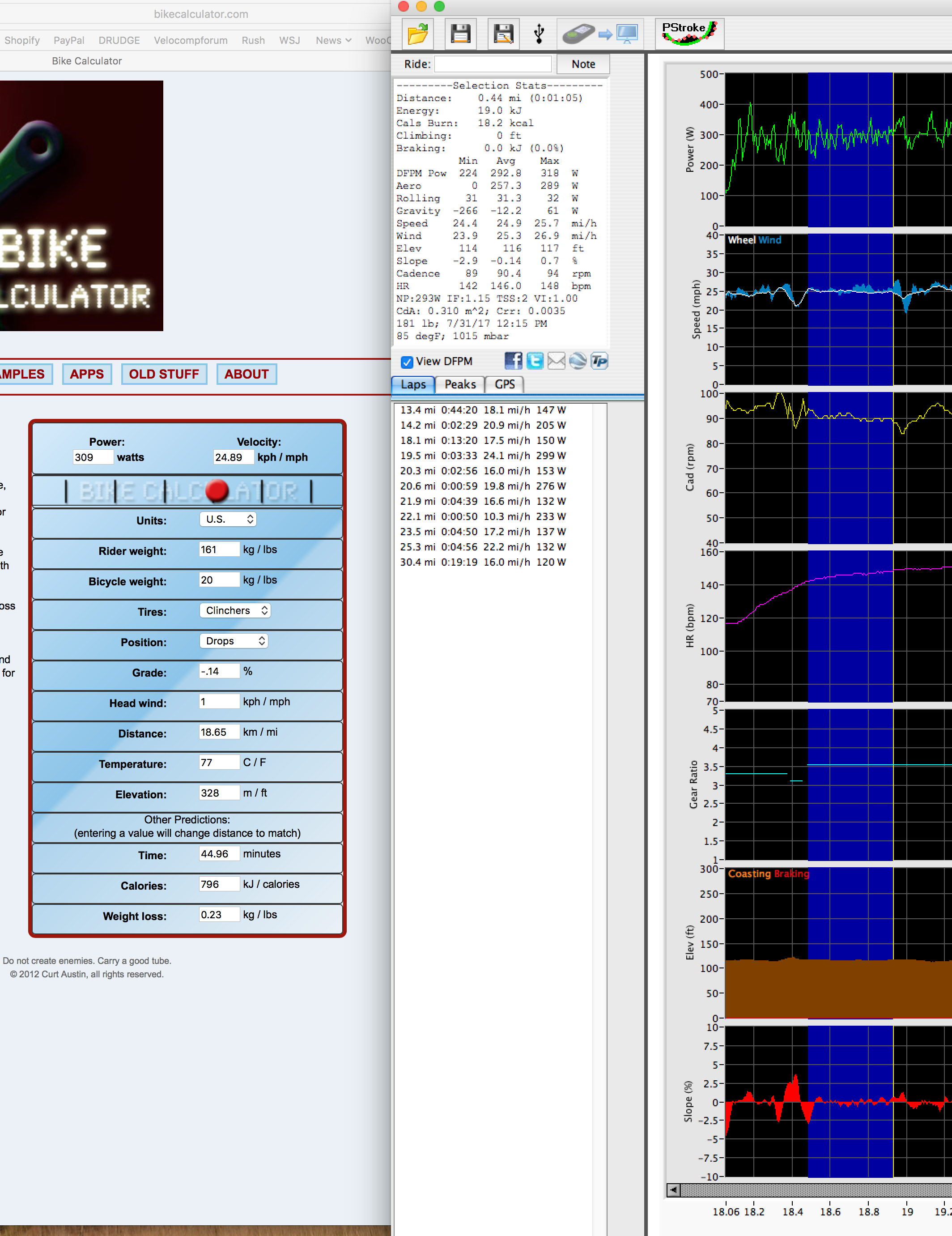

Lap 10 (downhill)
I selected a portion of this lap where speed, wind and slope were approximately uniform (the original lap 10 has too much variation)
Theory: 160W; Newton 162W, PT 135W
The PT is low
Lap 10, theory and Newton
Screen Shot 2017-08-01 at 6.01.43 PM.png (1.15 MiB) Viewed 24555 times
Lap 10, PT

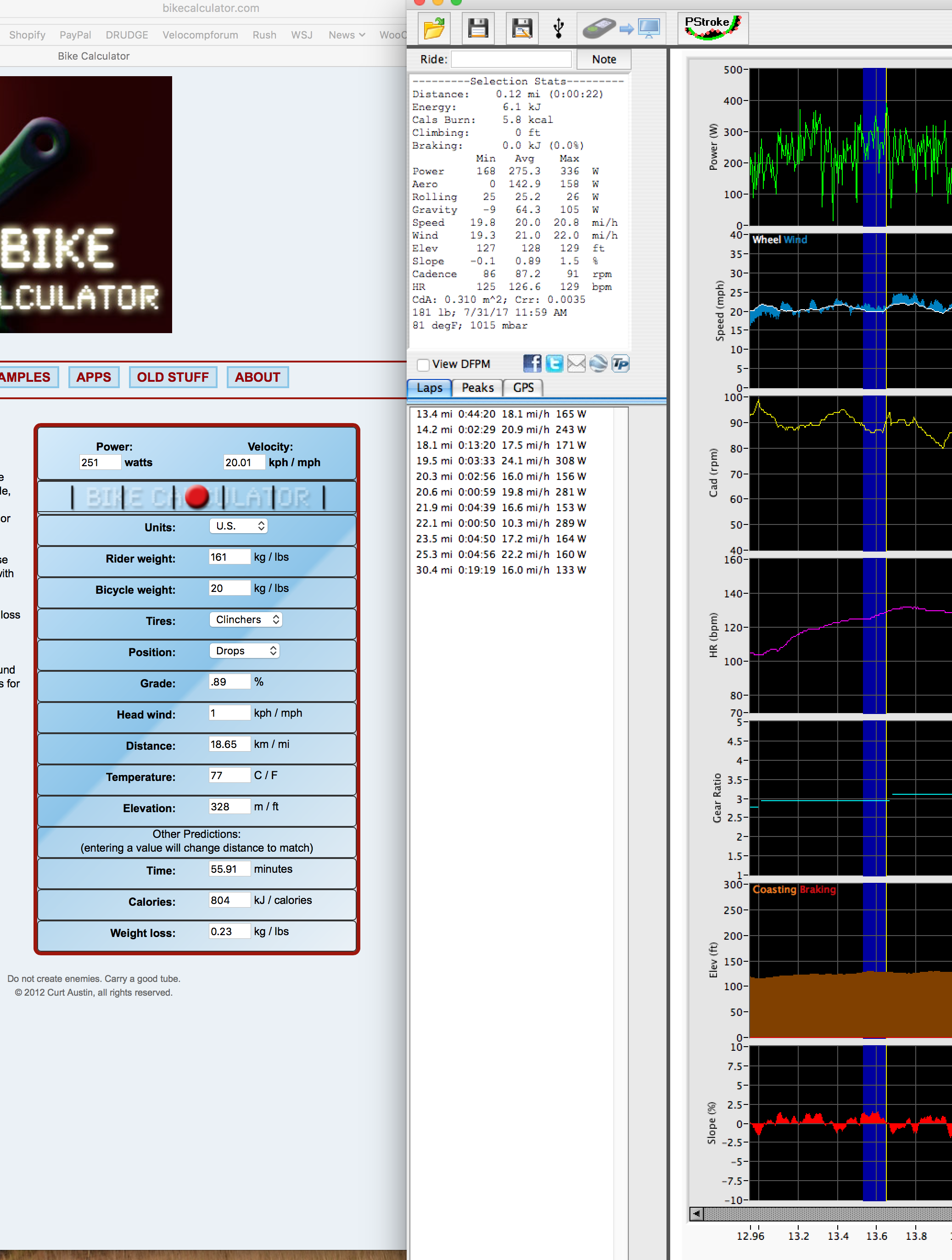

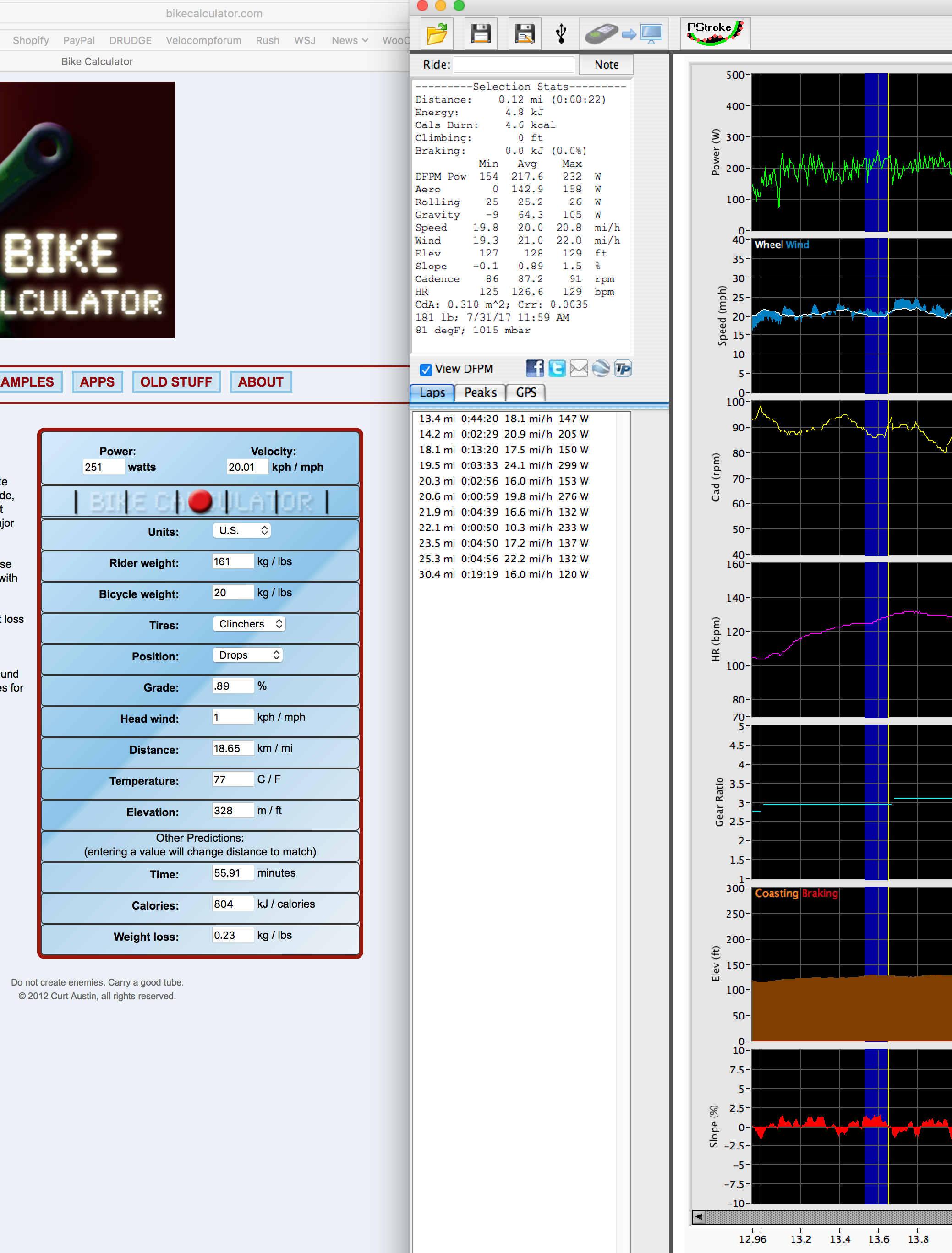

Lap 2
I selected a place where speed was unchanging.
Theory: 251W; Newton, 275W; PT, 217W
PT is low
Lap 2, Theory and Newton
Screen Shot 2017-08-01 at 6.06.18 PM.png (1.1 MiB) Viewed 24555 times
Lap 2, PT
Lap 2, PT
Screen Shot 2017-08-01 at 6.06.10 PM.png (1.06 MiB) Viewed 24555 times

I think the Newton is good at math, and it just might be that your PT is ready for some factory service. :-)
