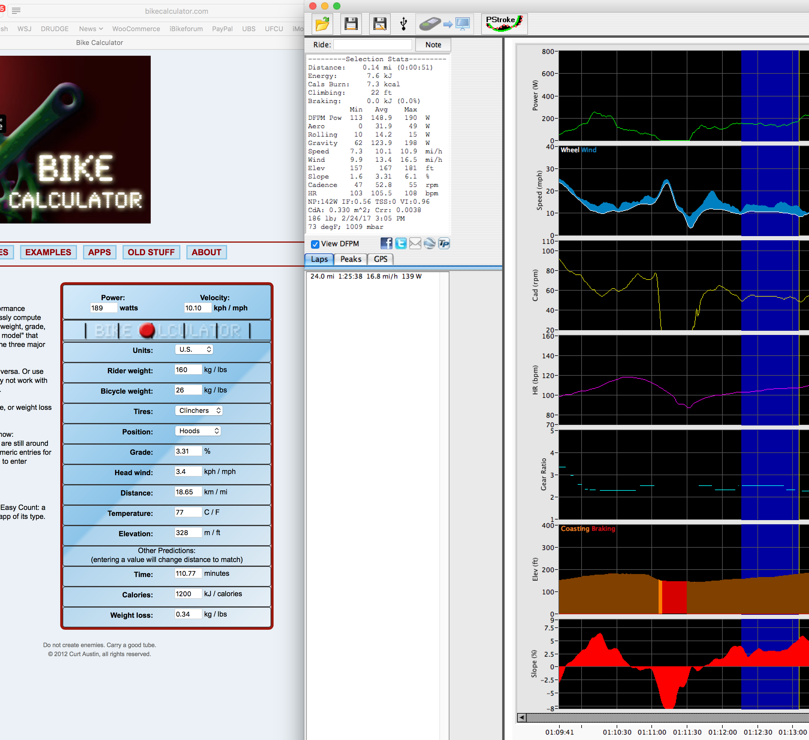

In the screen shots below, I input to bikecalculator.com the parameters of the ride segment I've selected. I show the Newton measurement for that section, and the PT measurement for that same section
1) Hill climb, time 1:12:30. Slope 3.31%, bike speed 10.1 mph, headwind 3.4 mph, rider weight 186 pounds. On hills, gravity watts dominate. If bike/rider weight is correct, then Newton watts should be solid. PT: 148.9, Newton reading: 182.8, bikecalculator: 189W. Newton is correct.
2) Flats. I picked a 1 min 42 segment around the 15 minute mark: 0.72% slope (pretty flat), bike speed 18.7 mph, wind speed -0.2 mph. In this section, wind force dominates. If wind speed and CdA are correct, then Newton watts should be solid. PT: 157.5W. Newton: 231.4W. Bikecalculator: 225W. Newton is correct.
3) Sprint. This is where both acceleration and wind are important. I picked the second sprint, around mile 12. Bike speed 24.2 mph, wind speed -0.9 mph, slope 0.57%. PT: 312W. Newton 368W, bikecalculator 375W. Newton is correct
In all of these sections (and everywhere else where I checked at random) the Newton was nearly identical to bikecalculator, and the PT reads low. How can this be? Well, all DFPMs require calibration prior to riding, and for best results they need to be re-zeroed during the ride. I have a PT wheel and when calibrated it works just fine. But I do find that calibrating it is a somewhat mysterious process, and that I some times think it is calibrated when, in fact, it is not. This is not a criticism; I am probably doing something improperly.

John, Wow! Thanks for doing all that work, I really appreciate it and it's helped me understand what's going on. First I want to assure you that although what I wrote, and what I write here, may sound confrontational or argumentative it's not intended in that way. I'm trying to solve a problem because I really like the idea of the Newton and I want it to work for me. The problem is this, I live in the northeast, I spend 5 full months a year on the indoor trainer, which is an Elite RealAxiom and not on your list of supported trainers. It gives me power readings based on speed, I want to true those up to the Newton. The Powertap wheel is lingua franca that allows that. By choice of tire and tube, and how many turns I use on the mechanism that pushes the trainer's roller into the bike wheel I've been able to equate the PTap to the RealAxiom (pretty much, the curves are a little different). So getting the Ptap to match up with the Newton means my work 5 months of the year is in concert with 7 months I'm outside with the Newton.
Let me address your technical concerns/comments in turn. Calibration: since I was using a Powertap Joule alongside the Newton the first question is if the Newton is properly calibrated to the Ptap hub. It is. The Joule does auto calibration everytime I stop peddling for 4 seconds or longer, which happens frequently, and did at least once before the first of the segments you analyzed. The Joule's power readings match the Newton's DFPM readings, therefore the Newton is calibrated correctly.
This is a general comment that will apply to all sections: the power/speed website you use isn't fine tuned for the purpose at hand. We have no idea what the Crr and Cda values are that correspond to "clincher" and "hoods". I use cyclingpowerlab.com for stuff like this. Although I can't change Crr, it's set to .400, I can change everything else including Cda, which I've set to both .0035 and .0033 for comparison, figures below reflect .0035 for hoods.
Section 1, hill. I know all of these sections of road very well, I ride them almost everyday I'm outside. This section is a gradual incline who's slope increases slightly, there are no flats or negative slope sections. The ISAAC screen shows a minimum altitude of 157 ft, which is at the start, and a max of 181 ft, which is the end, 14 ft gain. Ridewithgps shows 16 ft over that section, which we'll use. This is a grade of 2.2%, not 3.3. The power required according to cyclingpowerlab is 133 watts. Newton showed 183, Ptap 149. 40 watts of the error is in how Newton measures slope. If it had used it's own altitude measurements instead of it's calculated slope it would have been much closer. See attachment 1.
Section 2, flat. This segment is .52 miles, Newton reports an altitude gain of 12 feet (ridewithgps says 11). It looks dead flat while riding but we'll use 12 feet over .52 miles, or a slope of .4 %. Speed is 30.1 kph, wind is -.32 kph. Computed power is 155 watts. Ptap said 157, Newton 231. See attachment "Section 2".
Section 3, sprint. Here Newton gets the slope correct (1 ft gain over 106 feet, < 1%) but goes awry someplace else. Cyclingpowerlabs computes the watts required at 24.1 mph and -.9 wind to be 294. Ptap was 313, Newton 368. I think it's worth looking at the wind here. In the space of 3 seconds Newton is showing a wind variance of 2,1 mph, possible I guess, but it seems unlikely. See attachment "Section 3".
When Cda and Crr values close to watt I've programed into Newton are used in the calculations Ptap figures are much closer than Newton's. I have to believe the unit is not measuring slope and wind correctly, overstating both in all cases. Is there something that can be done to make slope and wind more accurate? I do a Wind Cal before most rides.
- Section 3 sprint.png (113.49 KiB) Viewed 38953 times
- Section 2 flat.png (113.34 KiB) Viewed 38953 times
- Section 1 uphill.png (110.28 KiB) Viewed 38953 times

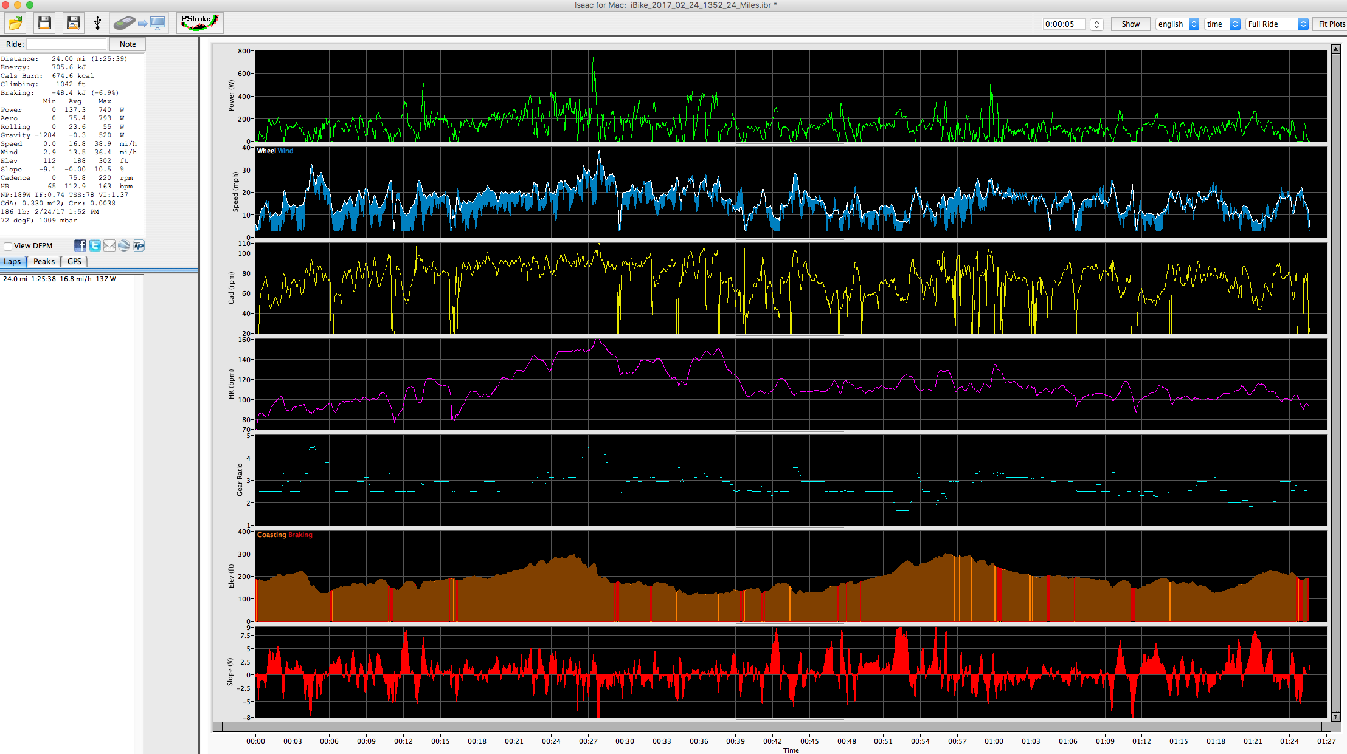

I finally got outside to do another ride with the Ptap and Newton. Different bike this time, also recent Cal ride. The results are closer when viewed in ISAAC than the last ride we discussed. But here's an effect I noticed not just today, but with that previous ride and most others: during the ride the power numbers from Newton and the Joule are always different except for low speeds up steeper grades when I'm applying fairly equal power over time, then they're very close. Part of the during ride discrepancy is also because the Newton readings are lagging the Joule when increasing or decreasing power (decreasing power evokes the greatest discrepancy to the Newton's readings), and this is true whether the Newton is displaying its computed power reading or the Ptap hub readings. Today the Joule was doing 10 sec averaging and the Newton dynamic, but when I've set both to 5 or 10 second averaging the Newton is always several seconds behind the Joule.
On the previous ride, which had a 40 watt average difference, that difference was reduced to about 20 when I did "Analyze Route". Today the raw difference was only 10 watts which got reduced to 2 (!) after Analyze Route. Analyze Route 90%+ of the time brings the Newton's original power down, and doing that correction seems valid since my route almost always has at least the same first and last 5 miles, and many times, like today, the first and last 10 miles are on the same road. It always brings the average wind down to about 0, +/-. Before correction on almost all my rides Newton has me riding into a net headwind, and this is after doing Wind Cal's before most rides.
So here's the bottom line, or so it seems to me: to be useful during a ride, for the Newton to tell me what I'm doing at the moment, it would need to get rid of the 3 to 10 second lag in power changes (the Ptap and Joule show changes almost immediately when I change my effort) and it would need to get the wind reading more accurate, to the level eventually achieved by Analyze Route which trued up today's ride very nicely with the Ptap. It all well and good to have it be correct eventually for after the fact analysis, but what I really need to know is during a hard workout, TT, crit or road race whether I'm in the red, at FTP, below, etc., at any particular moment.
John did you ever figure out why applying the same ride profile as used in the ride afterwards in "Change Profile After Ride" gave different results. That manipulation also almost always results in lower power, more similar to Ptap numbers, than the original Newton readings.
