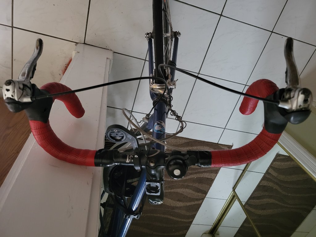

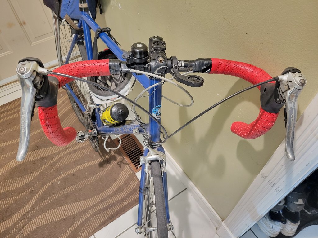

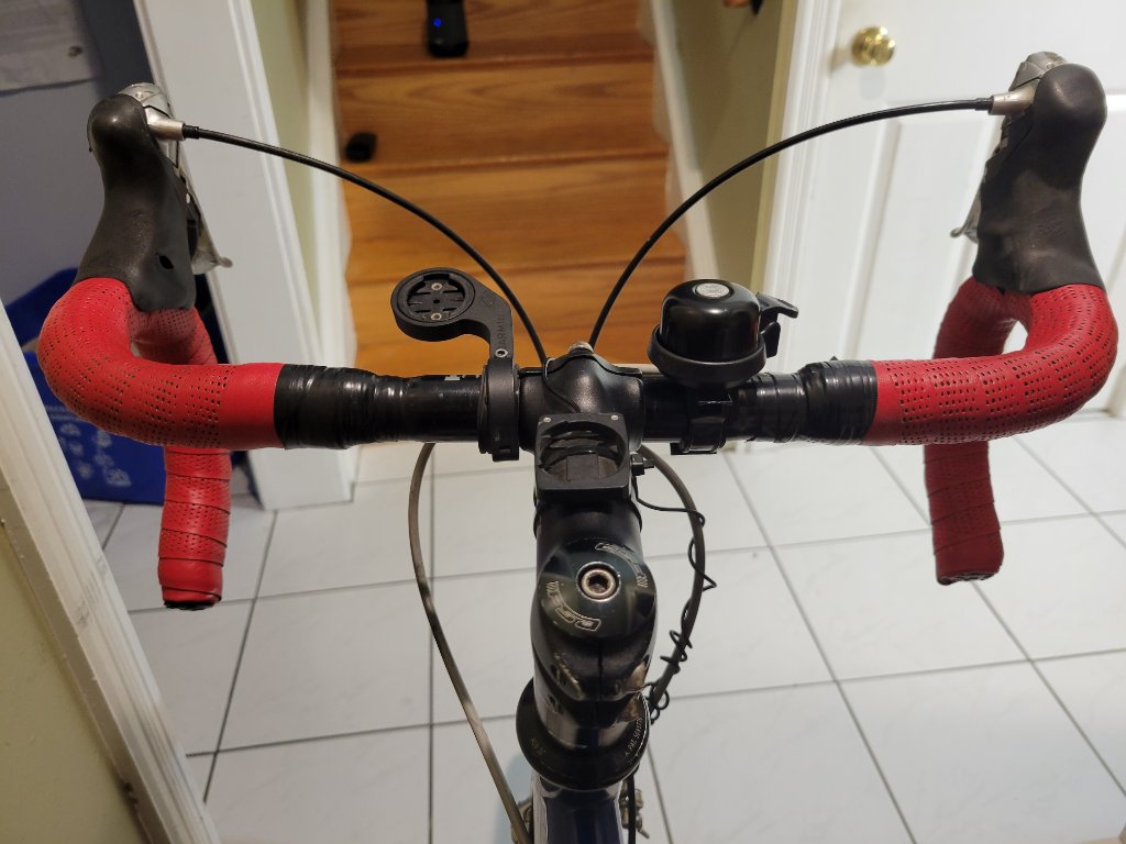

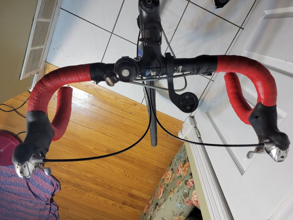

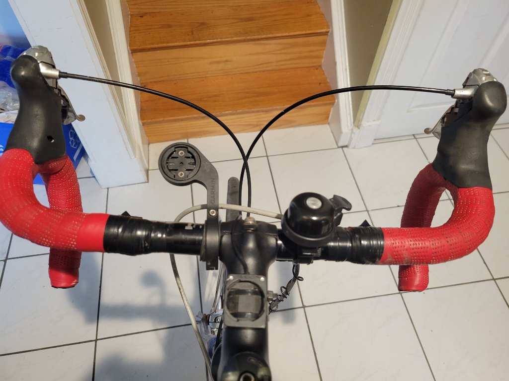

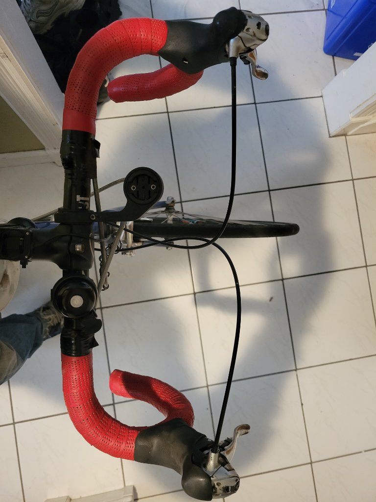

Here are three photos. You may notice the drops in the handlebars are angled down. This is intentional. A bike fitter had set it up this way a number of years earlier. It had been parallel to the ground and I just rotated them again last night. With this new rotation the PP would probably be better underneath the handlebars, instead of on top. Alternatively, if I placed it on the Garmin mount, the pitot might even extend beyond the cables.
I am also considering another bike fit at some point this summer, so it might change things again.
photos showing layout of cables
Re: Questions about PP V5
Where your front mount is now will work fine with our Combo mount.
Alternatively, you could attach the front mount to the right side of your HB, and place the bell on the other side. That would put the PP in the center of the bike.
Either way will work well.
