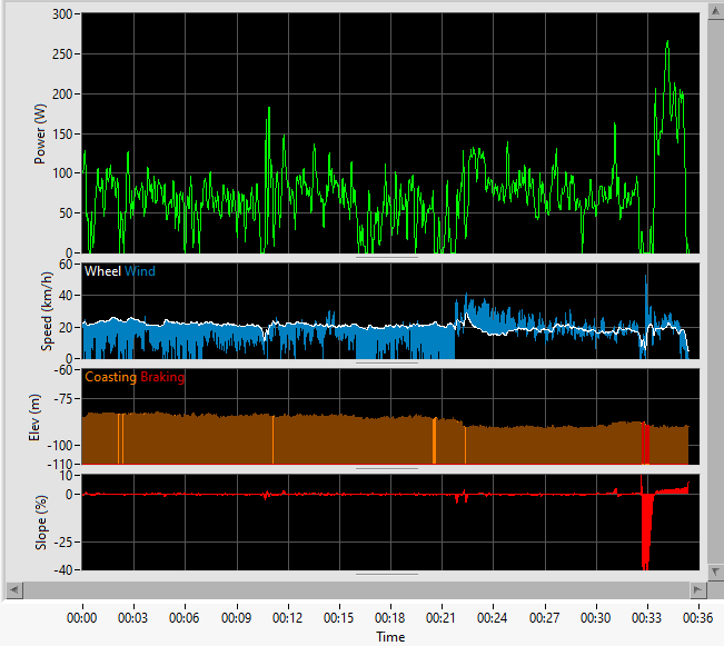

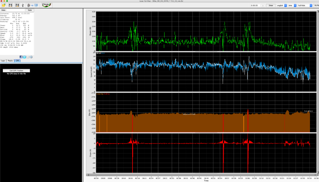

Hi.
Attached is a ride ending at a high power after having hit a bump in the road.
iBike_08_20_2019_1420_12_km.ibr
(102.42 KiB) Downloaded 1426 times
(Please, don't bother about the absolute power values, depending on my accepted calibration obviously).
My Powerpod sits tightly on my handlebar, but the handlebar has a suspension in the bike frame to its front wheel,
not being a race bike, but a sporting one.
Did I gather correctly that a suspension move may result in such off power values?
Is there anything to be done preventing such odd power values?
Posts: 8047
Re: high power at road bumps
Yes, what you are seeing is the effect of the suspension on power readings. When you hit a bump your PP momentarily is knocked out of its usual position, causing power changes.
The best way to minimize this problem is to lock-out your suspension.

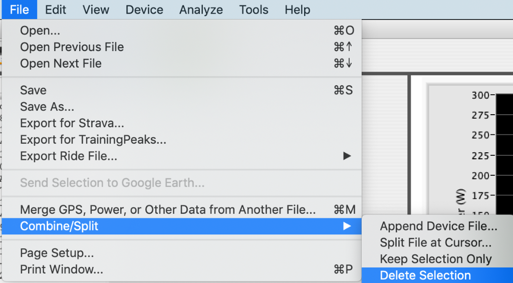

If you are using your ride files for training purposes, after the ride you can highlight the "bumps" and remove them from the ride file:
Screen Shot 2019-08-21 at 11.23.15 AM.png (142.59 KiB) Viewed 328269 times
Screen Shot 2019-08-21 at 11.22.51 AM.png (734.25 KiB) Viewed 328269 times
Screen Shot 2019-08-21 at 11.22.31 AM.png (145.97 KiB) Viewed 328269 times

Thank you, John, locking the suspension not being an option on my bike, I'll have to remove the results - though it would seem rather arbitrary.

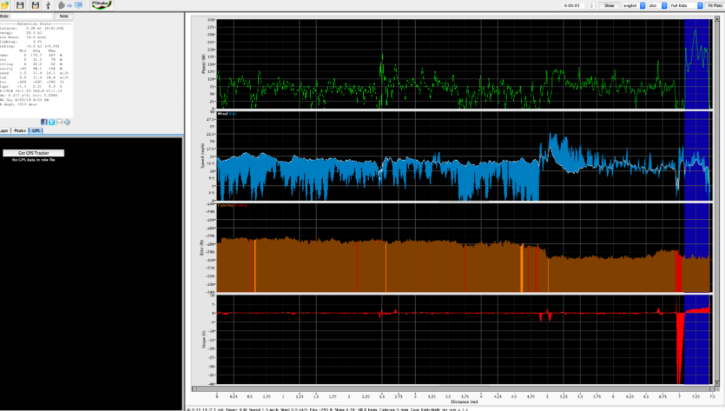

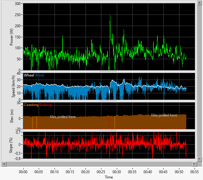

jonao wrote: Sat Aug 24, 2019 2:38 pm today's ride iBike_08_24_2019_1146_34_km.ibr
Your unit is not calibrated; you have a default value of wind correction in your ride file. Load the attached profile into your device.
I deleted the first 5 minutes of your ride, then used a trick to fix your calibration: the "Analyze/Analyze Route" command.
After applying the Analyze Route command it's obvious where your position changed.
Screen Shot 2019-08-24 at 3.52.43 PM.png (150.71 KiB) Viewed 328210 times
I deleted 3 small sections, each about 4 minutes long. You have plenty of data for your training analysis!
Screen Shot 2019-08-24 at 3.56.26 PM.png (167.02 KiB) Viewed 328209 times
Your CdA seems quite low; what is your height, and are you riding on the hoods or perhaps upright?

2) I tried correcting the ride as you did, the result looking similar, but my max slope still being at 49%, while yours is 6%. Any idea?
your corrected ride.PNG (136.85 KiB) Viewed 328193 times
my corrected ride.PNG (137.52 KiB) Viewed 328193 times

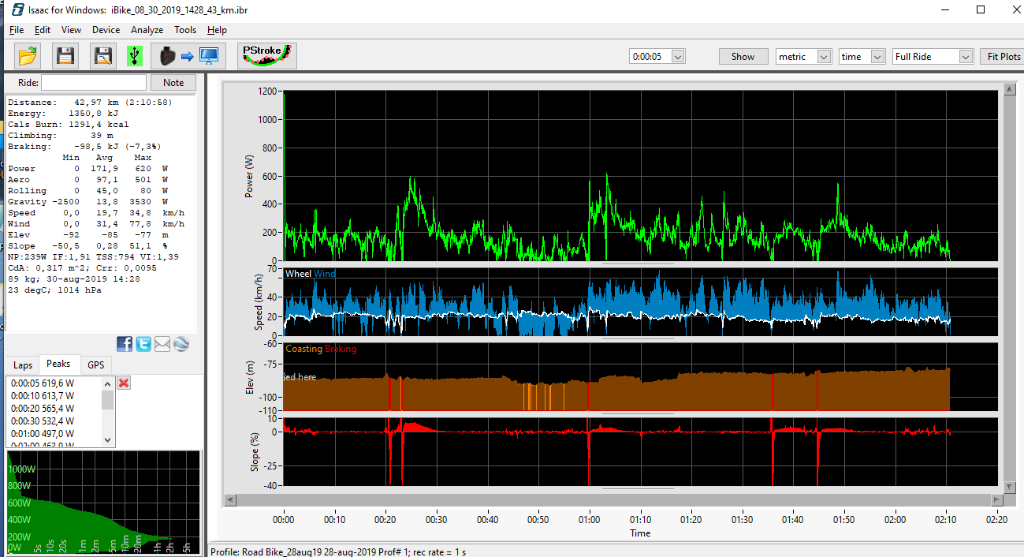

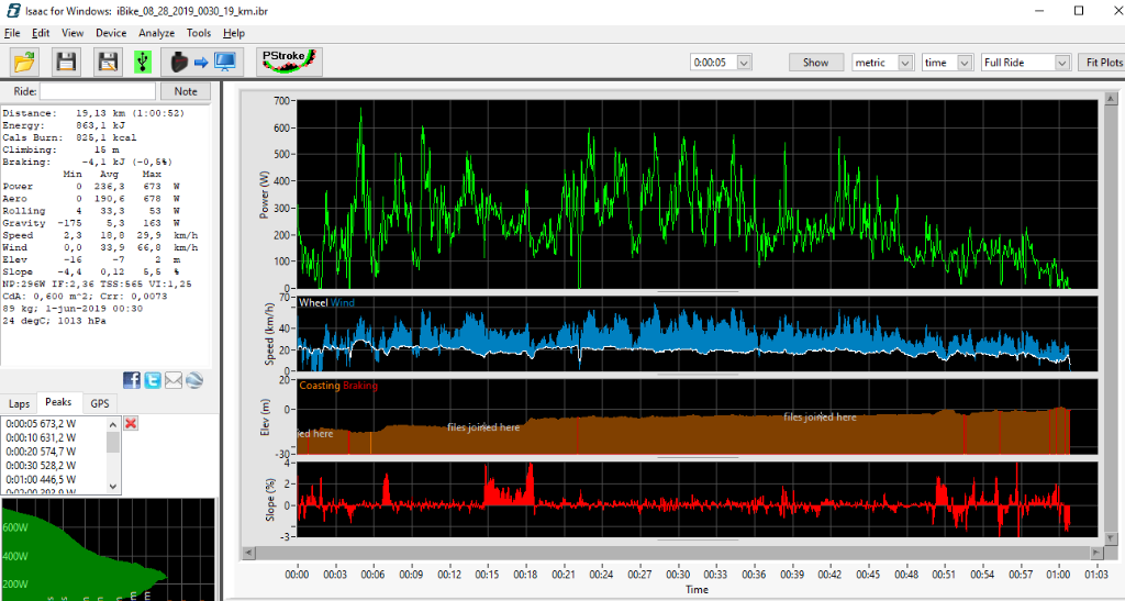

disappointment: In today's new ride, after reading it into Isaac, the values of CdA&Crr are NOT as those exported, but the original values back which I especially had replaced;
todays:
CdA has unwantedly been switched back.PNG (198.67 KiB) Viewed 328030 times
set profile 2 days ago:
settings of 20190828 as sent to device PP.PNG (196.17 KiB) Viewed 328030 times

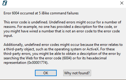

also I received an unknown error 6004 while automatic downloading from PP to Isaac, and only after closing the error message was able to download from the PP.
