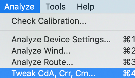

1) Open the ride file

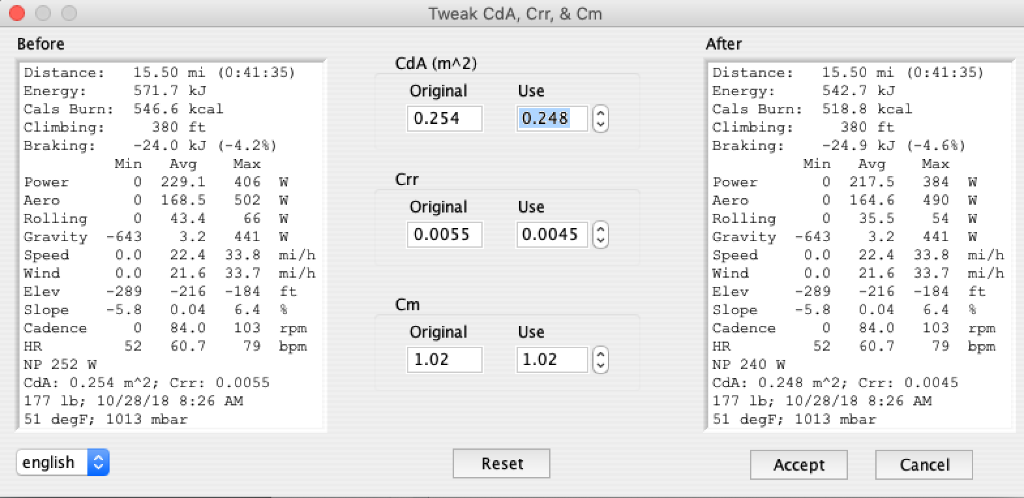

2) Select "Analyze/Tweak CdA, Crr, Cm"
Screen Shot 2018-11-03 at 6.58.43 AM.png (158.86 KiB) Viewed 4459 times

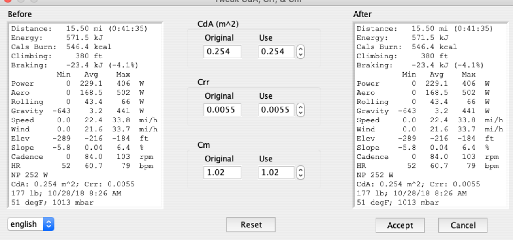

3) This window will appear (your data will be different):
Screen Shot 2018-11-03 at 7.00.54 AM.png (145.33 KiB) Viewed 4459 times

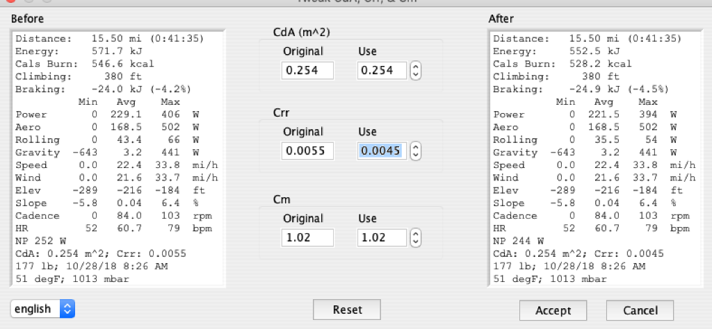

4) You will see the values of CdA and Crr used for this ride file. Change Crr to whatever you would like it to be; click Accept. In this example I've adjusted it to be 0.0045:
Screen Shot 2018-11-03 at 7.23.21 AM.png (126 KiB) Viewed 4459 times
5) Click Accept. Isaac will recalculate AP watts using a Crr of 0.0045. You've now adjusted the ENTIRE ride file to a new Crr of 0.0045 (that is, AP watts are calculated on the basis of a Crr of 0.0045). The next steps will figure out the corresponding CdA with the tweaked Crr value of 0.0045

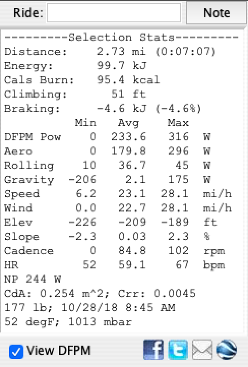

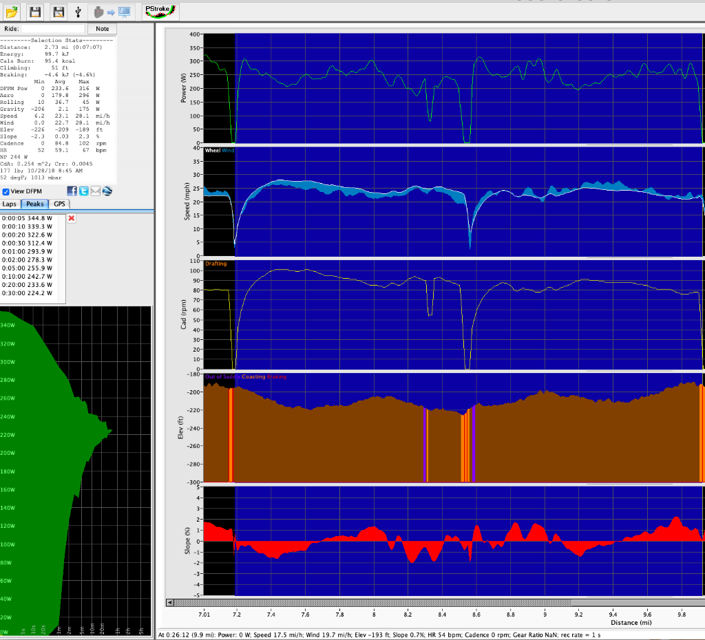

6) In the main window, check the "View DFPM" box, and highlight the section you'd like to analyze for CdA.
Screen Shot 2018-11-03 at 7.25.13 AM.png (190.56 KiB) Viewed 4459 times
7) Look at the "Average DFPM Pow" number in the Selection Stats. This is the average power measured in the interval selected (233.6W):

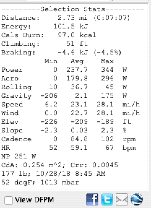

8) Uncheck the View DFPM box and look at the Avg Power. This is the average power measured by AP, using the assumed CdA value of 0.254 AND the tweaked value of Crr = 0.0045. (Both CdA and Crr are seen below the NP 251W in the selection stats window). In this example average power is 237.7W
Screen Shot 2018-11-03 at 7.32.28 AM.png (52.59 KiB) Viewed 4459 times
9) The governing principle of CdA measurement is that opposing AP watts should equal applied DFPM watts.
10) In this example, AP power (237.7W) is HIGH compared to DFPM power (233.6). Therefore, the assumed CdA of 0.254 is too high (the higher the CdA, the more watts AP will report).

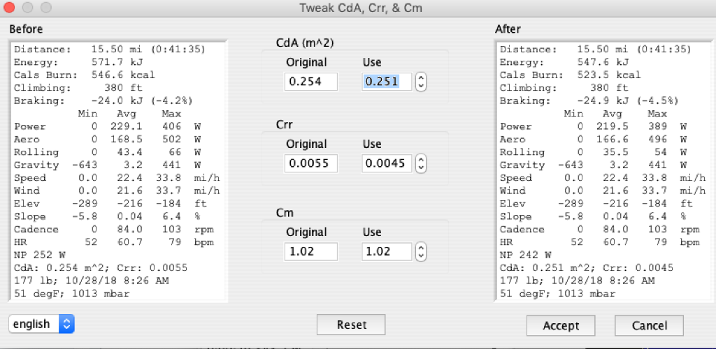

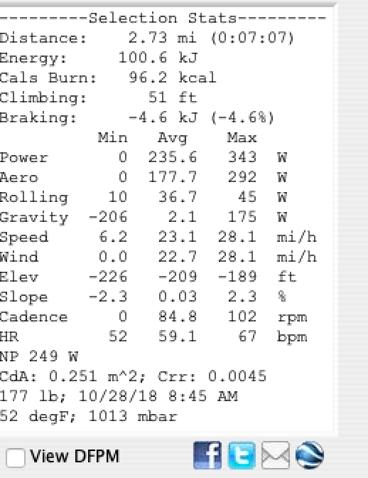

12) Go to "Analyze/Tweak CdA..." and type in a lower value for CdA (this is where you have to do some guessing). The applied/opposing watts values already pretty close, so as a first guess, I reduce CdA to 0.251,
Screen Shot 2018-11-03 at 7.43.44 AM.png (148.08 KiB) Viewed 4459 times
13) I click "Accept", and Isaac recalculates AP power with the new, assumed values of CdA = 0.251 and Crr = 0.0045. It reports 235.6--down 2 watts from the previous 237.7.
Screen Shot 2018-11-03 at 7.45.58 AM.png (53.53 KiB) Viewed 4459 times

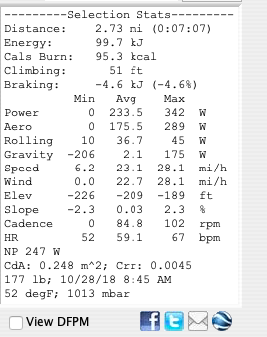

14) AP Watts dropped; we're moving in the right direction, but we still have 3 more watts to lose! a 0.003 adjustment reduced AP power by 3W, so for my next guess I reduce CdA to 0.248
Screen Shot 2018-11-03 at 7.50.34 AM.png (150.59 KiB) Viewed 4459 times
15) Click Accept: AP watts are now 233.5--dead on with DFPM watts of 233.6W!
Screen Shot 2018-11-03 at 7.51.42 AM.png (54.85 KiB) Viewed 4459 times
So, for this example, when we reduced Crr from 0.0054 to 0.0045, the associated CdA that balances opposing and applied watts is determined to be 0.248
