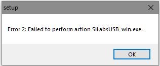

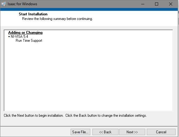

When I try to reinstall over the cureent install, the following is the result before the install starts:
And after the installer finish:
Please advise how to fix this.

I got it to work.
Uninstalling National Instuments software from the Control Panel, restarting, and running the Isaac installer fixed it. Without loosing my configuration etc.
I guess another software upgrade did something to the NI VISA install. The only recent install was Windows 10 Spring upgrade...
