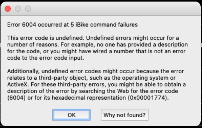

I recently installed Isaac 5.1 on my Mac after upgrading to ImacOS Monterrey. I followed the installation posted by user “dropsite” to the “letter” and the installation of the drivers and of Isaac 5.1 went smoothly as detailed in the instructions. I previously was running Isaac 5.1 on Imacos Catalina without any issues.
Unfortunately, since using ImacOS Monterrey and reinstalling Isaac 5.1 I have been unable to download any files from my powerpod 4. The connection shows the green button but when it attempts to download a ride the software comes up with the error 6004 (see file attached). I’ve erased all my files on the powerpod and repeated the process but the error reoccurs. I've also removed the drivers and reinstalled. The Isaac software appears to be functioning normally apart from this issue i.e. I cannot download any files.
Any help you can give would be greatly appreciated. My powerpod is running the latest FW 9.02 and has the 64-bit Isaac upgrade.
Thanks in advance
David.

Re: Intel Mac Users: how to install Isaac 5.1 macOS Catalina, Monterey, Big Sur, and earlier
Slickwhite wrote: Sat Mar 04, 2023 9:11 pm Hi John,
Thanks in advance
David.
I did not see any attachments to your original posting.
Connect your unit to Isaac, and go to Device/SN an FW version...
Post a screen shot of the response

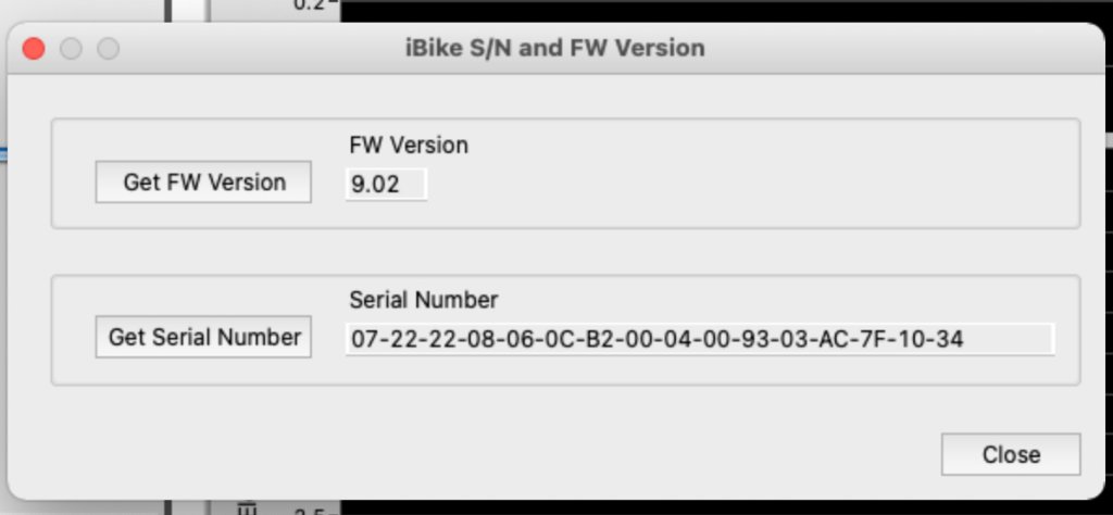

Apologies and thanks for responding so quickly
Screenshot of the error message and device /SN and FW version attached
Screenshot 2023-03-05 at 19.04.39.png (127.98 KiB) Viewed 122646 times
Screenshot 2023-03-05 at 19.05.05.png (60.55 KiB) Viewed 122646 times

Posts: 8047
Slickwhite wrote: Sun Mar 05, 2023 2:10 pm Hi John,
Screenshot of the error message and device /SN and FW version attachedScreenshot 2023-03-05 at 19.04.39.pngScreenshot 2023-03-05 at 19.05.05.png
Kind regards,
David.
Use the command Device/Erase All Ride files to get rid of the files stored in your PP.
Do a new, short ride, and try downloading it. Let me know if that works.

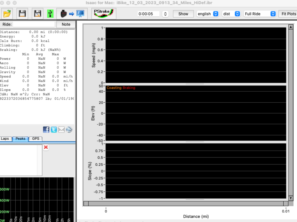

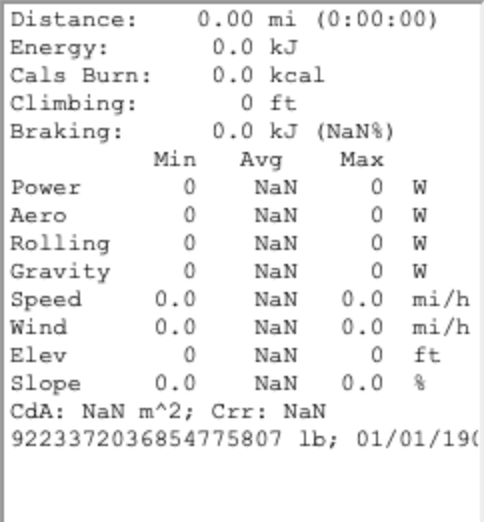

I tried as you suggested. erased the files followed by a short ride.
Unfortunately even though the powerpod connects to the Isaac software, it won't download the file automatically but eventually does when I perform a manual download. The file appears as shown below even though the powerpod was connected to my speed and cadence sensor and the correct power appears on my Garmin.

Posts: 8047
Slickwhite wrote: Mon Mar 06, 2023 6:13 pm Hi John,
OK, one more thing to try:
1) Press-hold PP button for around 12 seconds, then release after light goes out and starts flashing again. This does a hard reset
2) Erase your ride data
3) Another short ride, afterwards download.
Let me know...

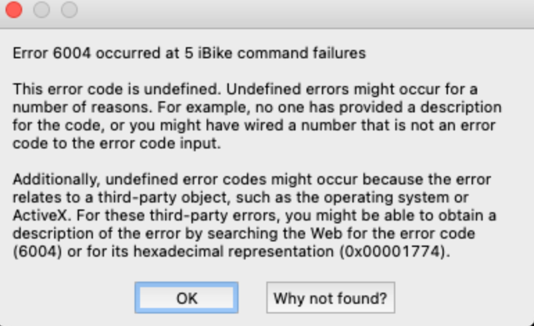

I did as instructed and performed a hard reset. After my ride I attempted to download the ride file and the error 6004 reoccured. I then tried to download the ride manually. The ride starts to download but s briefly flashes up the download window before disappearing. The ride appears as attached.
Screenshot 2023-03-12 at 17.13.09.png (153.74 KiB) Viewed 122492 times
I decided to downloaded Isaac for windows and downloaded Parallels and went for another ride. The ride downloaded without an issue. Not sure what's going on but a least it works with the windows version of Isaac.
David.

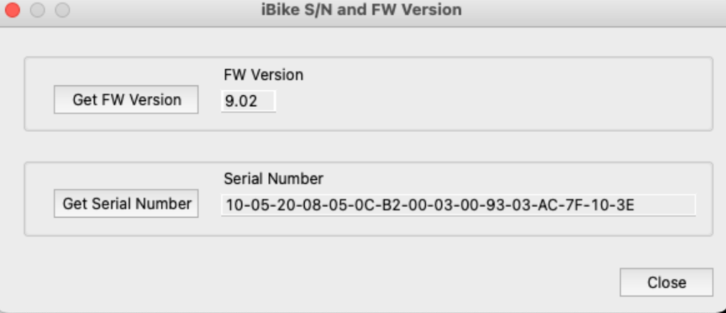

I emailed you about an error. I think it should be shared, so I'll write on this thread as well.
I recently started using a Powerpod 5. An error occurred when downloading data from Powerpod 5 using Isaac 5.1.
My PC is iMac with Monterrey. I have tried all the solutions presented in this thread in the past but they don't work.
Screenshot of the error message and device /SN and FW version attached.
By the way, it worked fine on Windows 10.
best regards,
Yuichi
Posts: 8047
If you can read your serial number, it is likely that the problem is an error in the file structure of your ride memory, making it impossible to download your ride.
The solution is to use the command "Device/Erase All Ride Data". You'll lose your ride data, but hopefully this will fix things.

I have followed your instructions 1 to 4, but no improvement.
The serial number and firmware version were obtained correctly. It was identical to the number shown in Windows 10.
Screenshot of Isaac for Windows is attached.

Yesterday I encountered exactly the problem you described when attempting to download ride files on my Mac, running macOS 13 and Isaac/Mac.
What version of macOS are you using?
Unfortunately it appears that Isaac/Mac is not compatible with your version of macOS. You will need to do the same thing that I do with my Mac: use Isaac/Windows. I have no problems running Isaac/Windows on my Mac.
Sorry...
