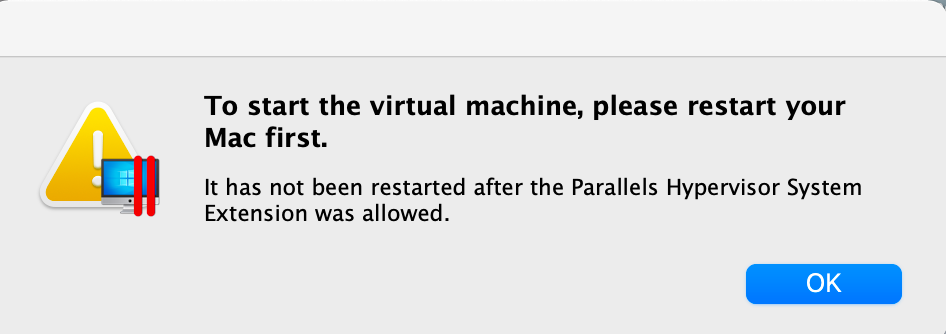

macOS 11.4 might ALSO break Parallels VM:. You will get this message when attempting to start Parallels:
Fortunately, with the help of forum member lorduintah, there is a workaround to the Parallels problem:
1) Make sure your VM is stopped (not suspended).
2) Go to Parallels Control Center, select "Hardware/CPU and Memory", click "Advanced Settings", and change Hypervisor from Parallels to Apple.

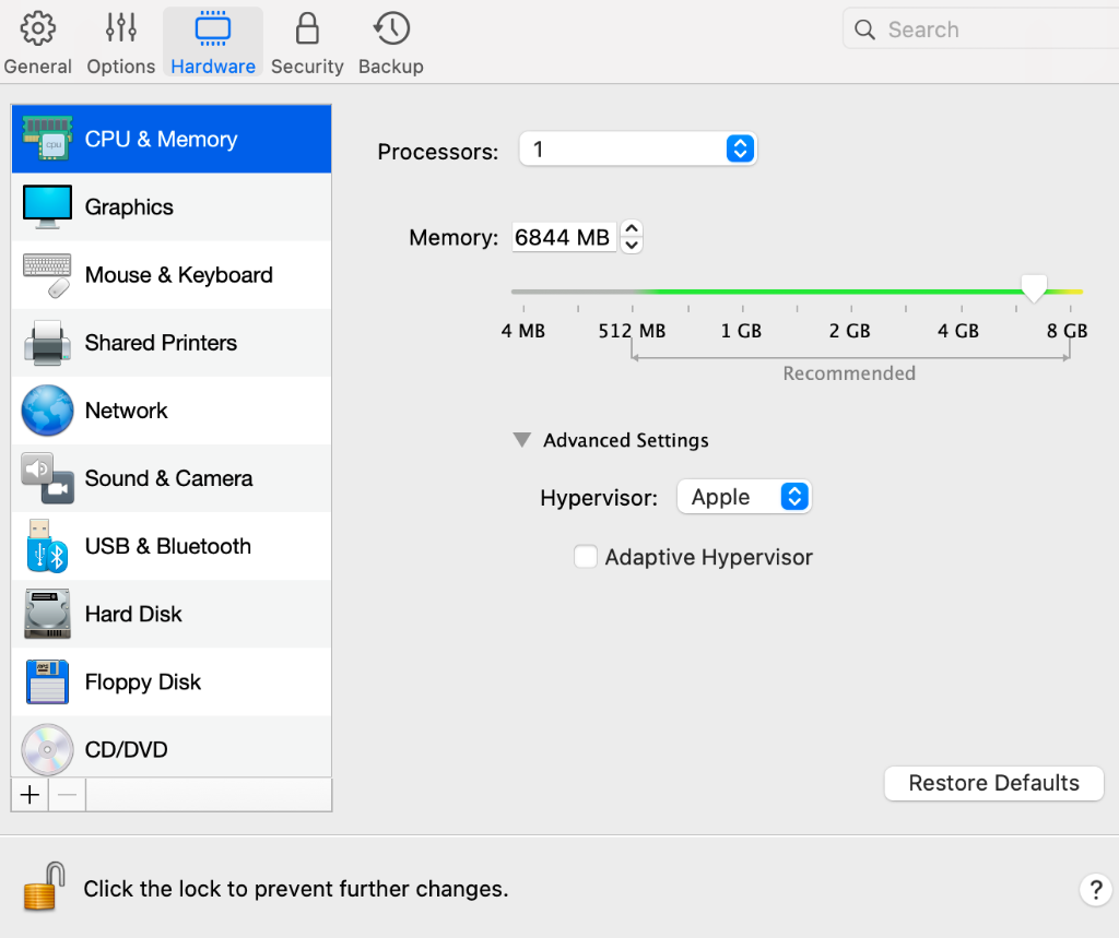

I have an M1 MacBook Air running OSX 11.4 with Parallels Desktop ver. 16. I have tried the fix suggested but my Control Panel doesn't have the Hyperviser option suggested, as seen below. Do you have any suggestions?
Bill
Bill
Re: WARNING: DO NOT UPGRADE YOUR MAC TO macOS 11.4
You can try clicking the "Adaptive Hypervisor" option.
Unless this happens to work, sadly, Isaac does not run with the M1 CPU. There is nothing we can do about this at this time.
Let us know what you find.
Changing the Hypervisor state doesn't appear to have any effect. I get this message regardless. I guess I will have to wait for a fix for either Parallels or Big Sur/M1.
Thanks, Bill
Thanks, Bill
- Windows startup error.png (120.01 KiB) Viewed 246546 times

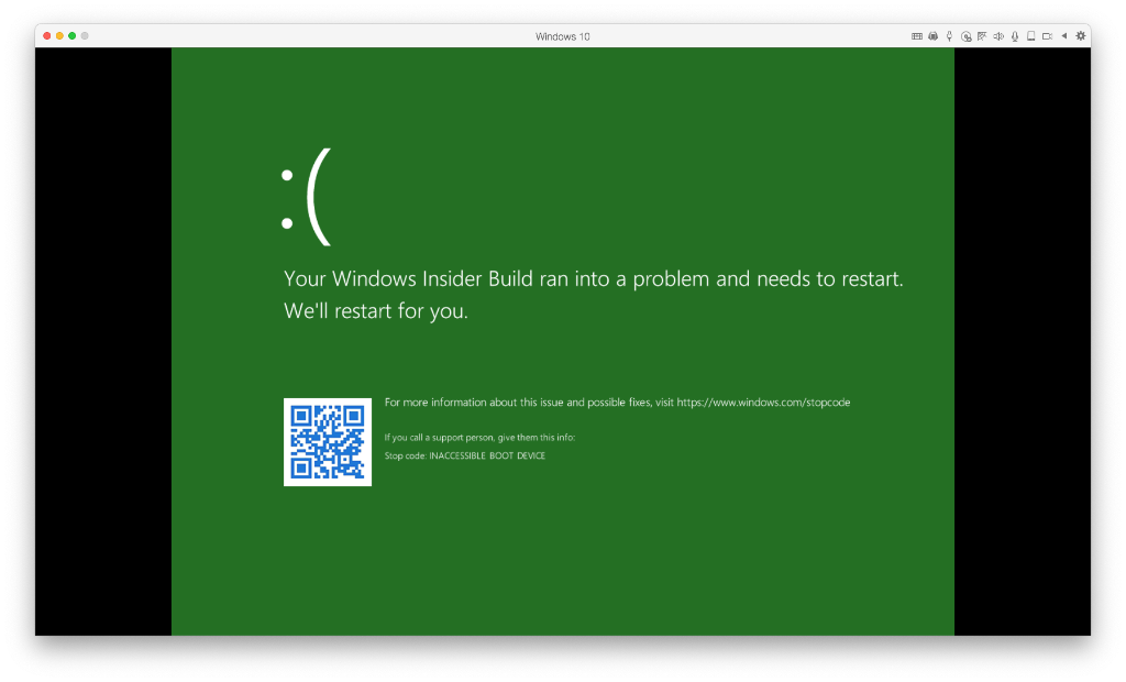

I don't know if this helps, but I'm running Windows 10 right at this moment on my M1 MacBook Air with Parallels v17. Shall I attempt to install Isaac?
I won't be able to test to see if it connects to Aeropod today as (doh!) this computer only has USB-C ports. Converter doesn't arrive 'til Wednesday.
It bricked my Windows install lol. Guess I'll try and install and older version of OS X and see if that works.
Just to be clear, you have Parallels V17 installed on your M1 Mac, and Windows 10. When you tried to install Isaac/Windows on Parallels, what happened?

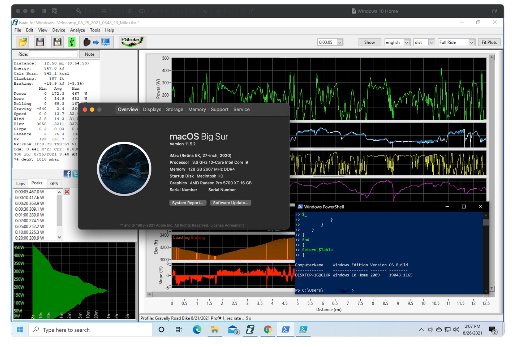

It works fine with Windows 10 inside VMware Fusion. I've had to do a lot of VM host and client testing over the years and VMware has typically been the best at both low level hardware passthrough (with proper driver/kexts support) and updates in case there's an issue. I imagine Player will be fine as well.
I don't have M1(x) hardware as of yet, so I can't test that. I'm out of the hardware testing biz...
- Image 8-26-21 at 2.07 PM.png (627.99 KiB) Viewed 245126 times
We have been using Parallels and Isaac/Win with Big Sur, without problems. It's on the macOS side with Isaac/Mac that Big Sur fails.fauxlty wrote: ↑Thu Aug 26, 2021 5:17 pm It works fine with Windows 10 inside VMware Fusion. I've had to do a lot of VM host and client testing over the years and VMware has typically been the best at both low level hardware passthrough (with proper driver/kexts support) and updates in case there's an issue. I imagine Player will be fine as well.
I don't have M1(x) hardware as of yet, so I can't test that. I'm out of the hardware testing biz...![]()
From all the reports we have, M1 won't work with Isaac, either on the Mac or VM side.
