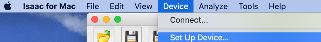

Yes, use the Device/Setup Device wizard in Isaac to do this
Screen Shot 2021-03-09 at 6.09.47 PM.png (205.17 KiB) Viewed 4837 times

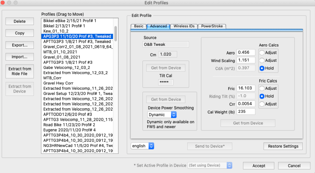

Yes, you can do this. Open your profile in Edit/Edit Profiles. Click on the Advanced Tab
Screen Shot 2021-03-11 at 2.54.15 PM.png (283.17 KiB) Viewed 4827 times

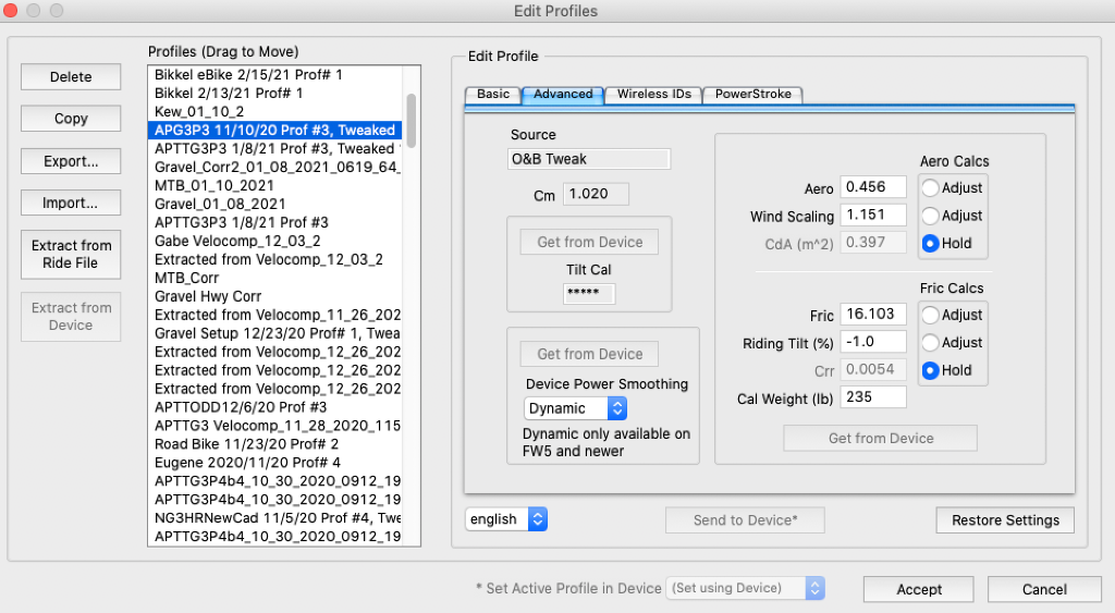

Click the radio button next to "Riding Tilt" to change it from Adjust to Hold
Screen Shot 2021-03-11 at 2.54.28 PM.png (301.09 KiB) Viewed 4827 times
Type in the Crr you want to use. Click "Send to Device" to update your PP. Rename the profile so you'll know it was for your gravel bike, then save the profile.
