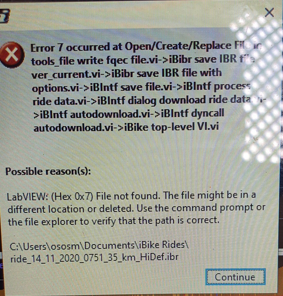

When downloading rides to my computer, I get an error 7, and the files are not being saved. Any help would be appreciated

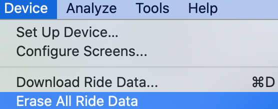

There is a corruption in your unit's ride file system
Connect your unit to Isaac, then use this command to erase your ride files. Unfortunately you will lose the ride files stored in your unit, but this will fix the problem.
Screen Shot 2020-11-14 at 6.39.25 AM.png (195.53 KiB) Viewed 2701 times
