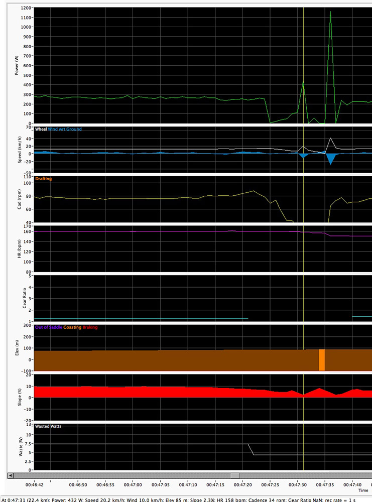

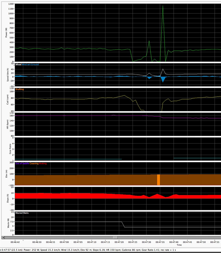

John, I have taken a closer look at one of these spikes from the ibr file I attached previously.
I certainly see the power spike in tandem with cadence anomalies, but I also see other artifacts, such as spikes/depressions in the wind trace, slope, etc.
I understand the relationship between speed/wind with the Newton. But the deflections don't appear to be organic and out of character with the adjacent parts
of the trace. Same with slop trace.
Gear ratio trace is null for about 20 seconds as well.
I have also uploaded a second closeup where cadence trace indicates zero, but the power trace is over 400W and the info bar at the bottom of the graph
tells a slightly different story. (For a shot duration the cadence trace indicates I stopped pedaling for a brief moment, seldom do I stop pedaling on a 6-7% slope, and certainly not for 6 seconds.
But if the Garmin GSC-10 sensor is failing, I could see that being falsely reported.)
I have provided a closeup, 2 minute view where I have placed the curser over the 438W peak and 0 cadence.
Is the slope, speed/wind and gear ratio anomalies consistent with speed sensor issue?
Forgive me if I am misunderstanding what I am seeing or I'm overthinking this. It's in my nature to understand things when I should simply accept.

Re: Exporting smoothed power data.
Speed spikes, not cadence spikes, are the underlying problem. They cause power, slope, and other errors.
