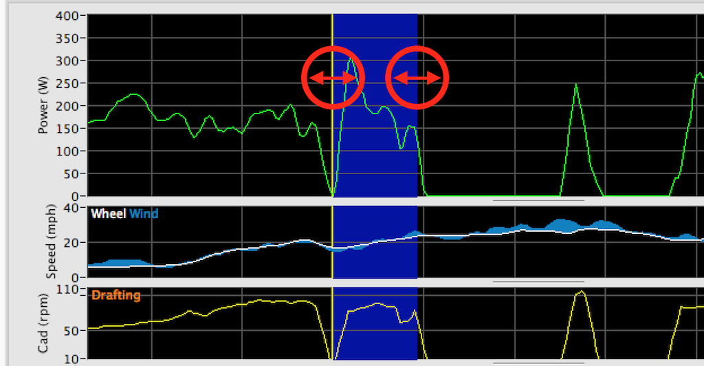

I would like to see improvements to the chart selection ranges like Russ and acerfern requested. Allowing us to modify and fine tune the start and end of a selection would be very helpful. In addition to acerferns suggested implementations, perhaps allow the user to type in the start and end points for the selection.

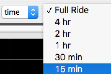

When I want to see more detail for part of the ride, I change the scale in the upper right corner from Full Ride, to something smaller. Then, I scroll to the part I want to look at in detail.

Re: Isaac feature request
How do you make small or large adjustments to your range selections?Velocomp wrote:When I want to see more detail for part of the ride, I change the scale in the upper right corner from Full Ride, to something smaller. Then, I scroll to the part I want to look at in detail.
In the upper right corner of the main window, click on "Full Ride", then adjust to a narrower range.
That's not what I'm asking. How do you adjust the end points of a selection?Velocomp wrote:In the upper right corner of the main window, click on "Full Ride", then adjust to a narrower range.
You've already done exactly that, with your drag-drop.
Yes, the selection is done, now how do you make the existing selection wider or narrower without starting the selection process over again? Do you understand?Velocomp wrote:You've already done exactly that, with your drag-drop.
There is no way to expand or contract the display except by using the procedures described previously.
Right, that is the feature being requested: the ability adjust an existing highlighted selection. I've created an animated GIF demonstrating the requested feature implemented in another software and linked to it below. In Issac, adjustment to the selected/highlighted region will extend across all displayed charts. Thank you.Velocomp wrote:There is no way to expand or contract the display except by using the procedures described previously.
