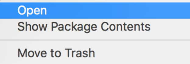

5) HOLD DOWN THE "CONTROL" key on your keyboard, then click on the Isaac icon. A new pop up window will appear
Screen Shot 2017-04-12 at 6.58.19 AM.png (69.55 KiB) Viewed 13184 times
6) Now, move your mouse over the "Open" option. The word "Open" will be highlighted
Screen Shot 2017-04-12 at 6.59.45 AM.png (59.76 KiB) Viewed 13184 times
7) Now, click on "Open" to start the installation process

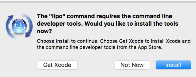

9) If, during your driver install, you see this message, click the "Not Now" button:
Screen Shot 2017-04-12 at 7.06.04 AM.png (91.67 KiB) Viewed 13184 times
