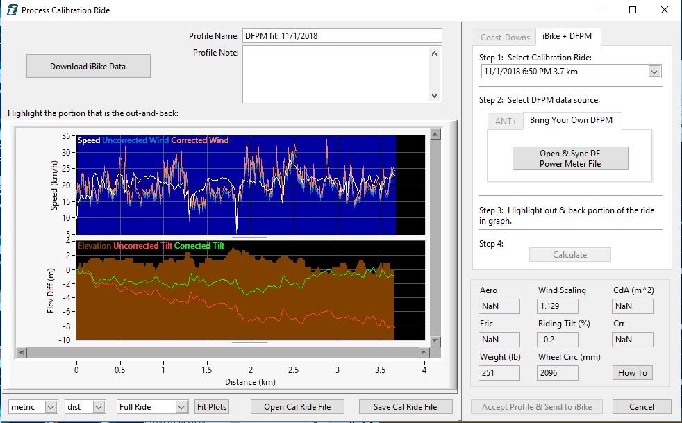

Managed to do another calibration ride today, I went to Device, Setup, Download calibration ride. And I got the screen again which assumes I have a DFPM attached, and the calculate button is greyed out.
I did however observe that windscaling field was populated.

I did a new sensor pairing.
Should Issac now be able to process the calibration ride?
I tried going to Issac again, but I still get stuck on the DFPM section.
- Capture.JPG (107.16 KiB) Viewed 65692 times
